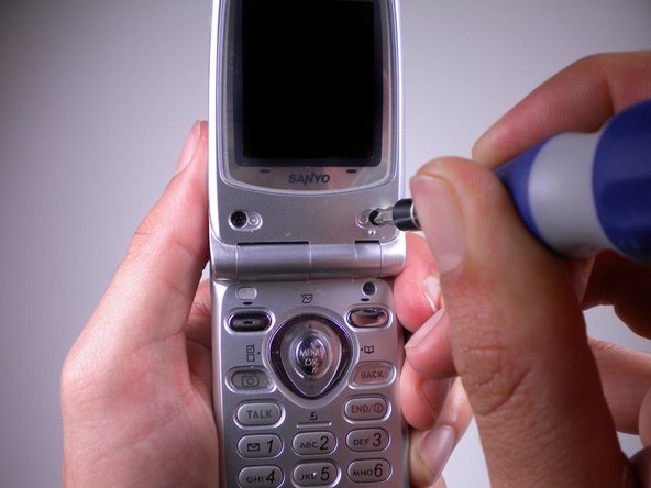

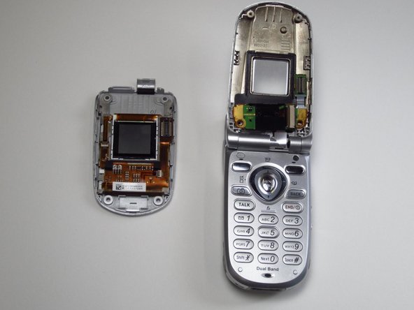

    • Open the phone and remove the four stickers that hide the four 0.5 mm screws.
    • On the bottom two, use a push pin to pull out the stickers.
    • Do this slowly and gently. You may damage the phone screen or tear the sticker.
  2. Sanyo SCP-8100 Camera Replacement: crwdns2935265:02crwdnd2935265:01crwdnd2935265:01crwdne2935265:0
    • For the top two, use the same push pin and gently pull out the stickers.
    • These are a bit harder to pull out, so you might need to use more force. However, be gentle or else you may tear the rubber off of the sticker instead of the whole plug.
  3. Sanyo SCP-8100 Camera Replacement: crwdns2935265:03crwdnd2935265:01crwdnd2935265:02crwdne2935265:0 Sanyo SCP-8100 Camera Replacement: crwdns2935265:03crwdnd2935265:02crwdnd2935265:02crwdne2935265:0
    • Use the Tri-Wing Y1 screwdriver to unscrew the now uncovered four 0.5 mm screws.

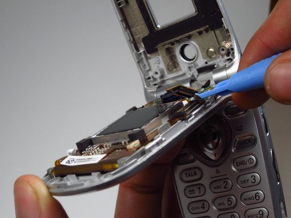

  4. Sanyo SCP-8100 Camera Replacement: crwdns2935265:04crwdnd2935265:01crwdnd2935265:02crwdne2935265:0 Sanyo SCP-8100 Camera Replacement: crwdns2935265:04crwdnd2935265:02crwdnd2935265:02crwdne2935265:0
    • Use the opening tool to pry open the front panel.
    • You might need to use some force. If it won't budge, try the other side of the panel. You may need to pry open more than one spot to get it completely open.

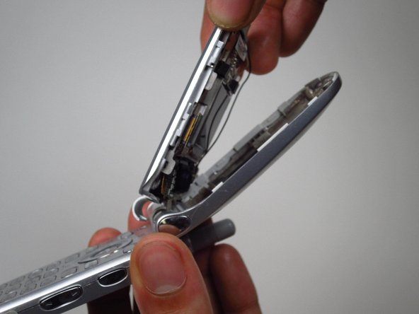

    • Don't completely remove the panel, it is still connected to the phone.

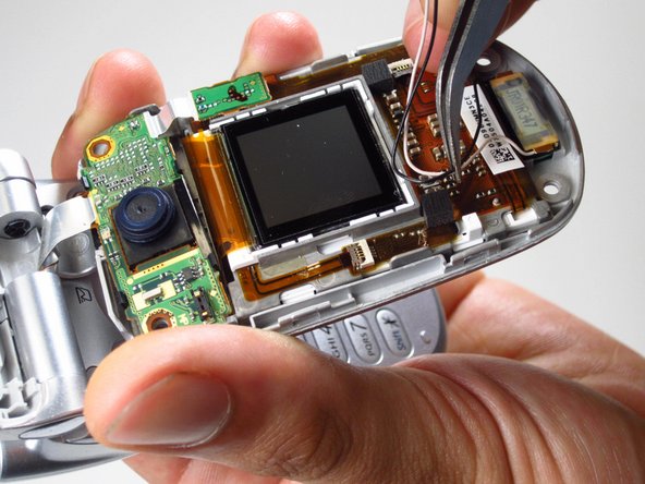

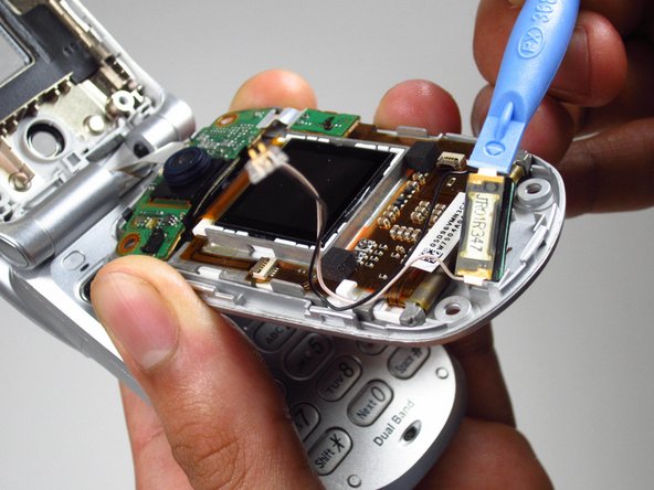

  5. Sanyo SCP-8100 Camera Replacement: crwdns2935265:05crwdnd2935265:01crwdnd2935265:02crwdne2935265:0 Sanyo SCP-8100 Camera Replacement: crwdns2935265:05crwdnd2935265:02crwdnd2935265:02crwdne2935265:0
    • Use tweezers to detach the plastic connector.
    • With the tweezers, pull the wires from the plastic clamp.
  6. Sanyo SCP-8100 Camera Replacement: crwdns2935265:06crwdnd2935265:01crwdnd2935265:02crwdne2935265:0 Sanyo SCP-8100 Camera Replacement: crwdns2935265:06crwdnd2935265:02crwdnd2935265:02crwdne2935265:0
    • Use the opening tool to pull the earpiece off of the top panel.
    • You may need to use some force to take this out.
  7. Sanyo SCP-8100 Camera Replacement, Camera: crwdns2935265:07crwdnd2935265:01crwdnd2935265:02crwdne2935265:0 Sanyo SCP-8100 Camera Replacement, Camera: crwdns2935265:07crwdnd2935265:02crwdnd2935265:02crwdne2935265:0

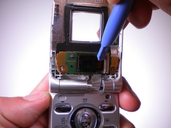

    • Use plastic opening tool to lift the chip on the right side.
  8. Sanyo SCP-8100 Camera Replacement: crwdns2935265:08crwdnd2935265:01crwdnd2935265:02crwdne2935265:0 Sanyo SCP-8100 Camera Replacement: crwdns2935265:08crwdnd2935265:02crwdnd2935265:02crwdne2935265:0
    • Use plastic opening tool to pry the board off of the front panel.
    • You may need to use force.
    • Completely remove the screen from the phone.

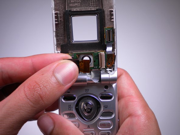

  9. Sanyo SCP-8100 Camera Replacement: crwdns2935265:09crwdnd2935265:01crwdnd2935265:02crwdne2935265:0 Sanyo SCP-8100 Camera Replacement: crwdns2935265:09crwdnd2935265:02crwdnd2935265:02crwdne2935265:0
    • Use the opening tool to take off the black plastic frame around the camera lens.
  10. Sanyo SCP-8100 Camera Replacement: crwdns2935265:010crwdnd2935265:01crwdnd2935265:02crwdne2935265:0 Sanyo SCP-8100 Camera Replacement: crwdns2935265:010crwdnd2935265:02crwdnd2935265:02crwdne2935265:0
    • Use the plastic opening tool to flip the ZIF connector to the right.

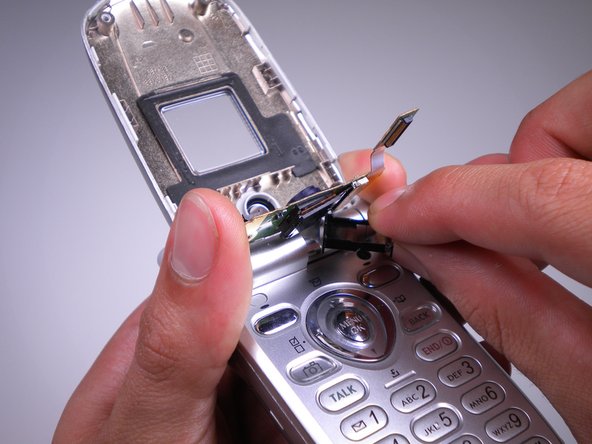

  11. Sanyo SCP-8100 Camera Replacement: crwdns2935265:011crwdnd2935265:01crwdnd2935265:02crwdne2935265:0 Sanyo SCP-8100 Camera Replacement: crwdns2935265:011crwdnd2935265:02crwdnd2935265:02crwdne2935265:0
    • Lift the camera from the opening.
    • Detach and pull the camera from the ZIF connector.
