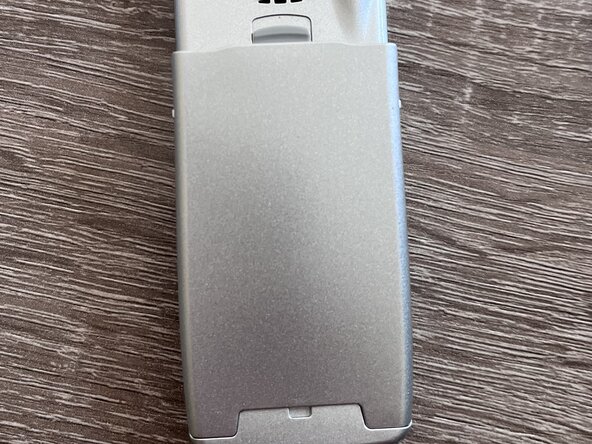

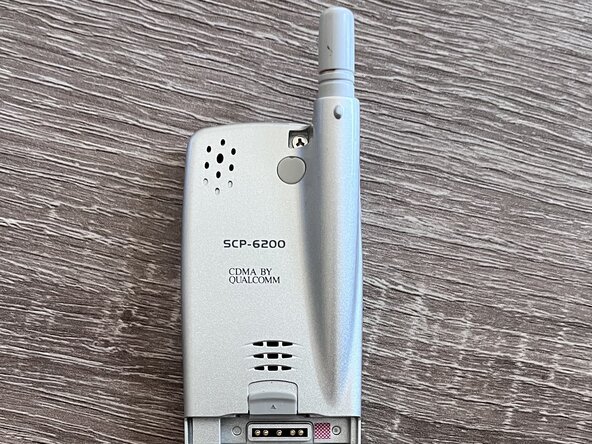

    • Remove the battery by pulling the switch on the phone’s rear side.
  2. Sanyo SCP-6200 Screen Replacement, Remove the visible screws: crwdns2935265:02crwdnd2935265:01crwdnd2935265:03crwdne2935265:0 Sanyo SCP-6200 Screen Replacement, Remove the visible screws: crwdns2935265:02crwdnd2935265:02crwdnd2935265:03crwdne2935265:0 Sanyo SCP-6200 Screen Replacement, Remove the visible screws: crwdns2935265:02crwdnd2935265:03crwdnd2935265:03crwdne2935265:0
    • Remove the 5 Y000 Screws on the back of the phone. 4 Under the battery and 1 near the antenna.
    • Remove the plastic cover next to the antenna.

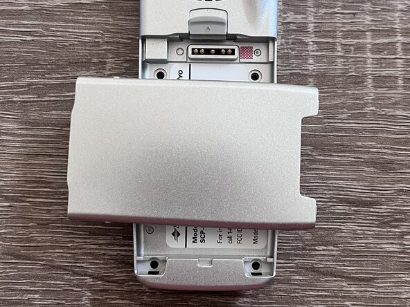

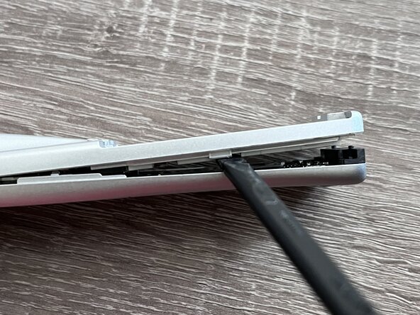

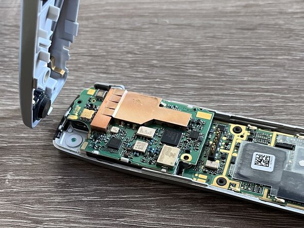

  3. Sanyo SCP-6200 Screen Replacement, Remove the back panel: crwdns2935265:03crwdnd2935265:01crwdnd2935265:03crwdne2935265:0 Sanyo SCP-6200 Screen Replacement, Remove the back panel: crwdns2935265:03crwdnd2935265:02crwdnd2935265:03crwdne2935265:0 Sanyo SCP-6200 Screen Replacement, Remove the back panel: crwdns2935265:03crwdnd2935265:03crwdnd2935265:03crwdne2935265:0
    • Use a spudger between the seams of the phone to detach the back panel from the rest of the phone.

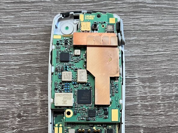

  4. Sanyo SCP-6200 Screen Replacement, Remove the Screw from the board: crwdns2935265:04crwdnd2935265:01crwdnd2935265:02crwdne2935265:0 Sanyo SCP-6200 Screen Replacement, Remove the Screw from the board: crwdns2935265:04crwdnd2935265:02crwdnd2935265:02crwdne2935265:0
    • Remove the Philips 0 Screw from the board.

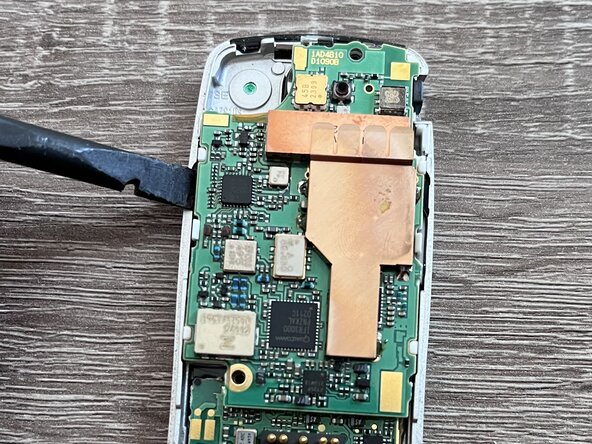

  5. Sanyo SCP-6200 Screen Replacement, Remove the board: crwdns2935265:05crwdnd2935265:01crwdnd2935265:03crwdne2935265:0 Sanyo SCP-6200 Screen Replacement, Remove the board: crwdns2935265:05crwdnd2935265:02crwdnd2935265:03crwdne2935265:0 Sanyo SCP-6200 Screen Replacement, Remove the board: crwdns2935265:05crwdnd2935265:03crwdnd2935265:03crwdne2935265:0
    • Remove the Motherboard from the phone using a spudger.

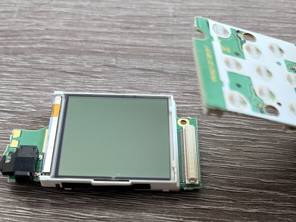

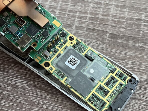

  6. Sanyo SCP-6200 Screen Replacement, Separate the boards: crwdns2935265:06crwdnd2935265:01crwdnd2935265:03crwdne2935265:0 Sanyo SCP-6200 Screen Replacement, Separate the boards: crwdns2935265:06crwdnd2935265:02crwdnd2935265:03crwdne2935265:0 Sanyo SCP-6200 Screen Replacement, Separate the boards: crwdns2935265:06crwdnd2935265:03crwdnd2935265:03crwdne2935265:0
    • Disconnect the top board and bottom board from each other.

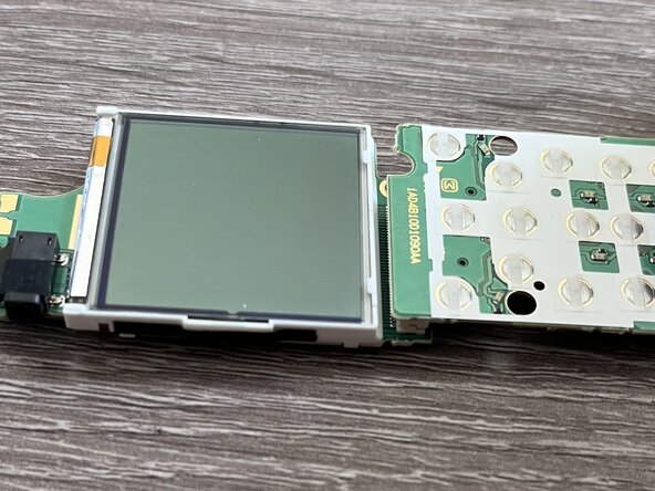

  7. Sanyo SCP-6200 Screen Replacement, Desolder the Screen from the board: crwdns2935265:07crwdnd2935265:01crwdnd2935265:01crwdne2935265:0
    • Desolder the display cable from the top board
