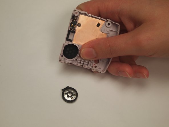

    • Remove the lower back cover to reveal part of the motherboard and the circular speaker housed in the back cover plate.
  6. Sanyo Katana Speaker Replacement, Speaker: crwdns2935265:06crwdnd2935265:01crwdnd2935265:02crwdne2935265:0 Sanyo Katana Speaker Replacement, Speaker: crwdns2935265:06crwdnd2935265:02crwdnd2935265:02crwdne2935265:0
    • Gently tap the lower back casing on a hard surface to remove the speaker.
