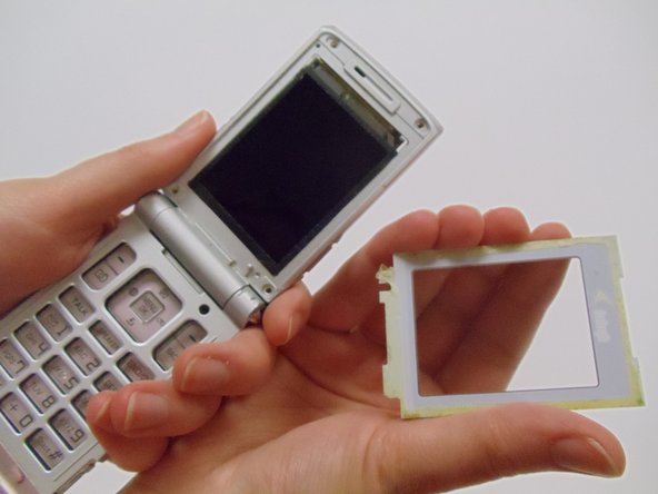

    • With the flat end of a spudger, remove the plastic covers located on the corners of the display near the hinge and above the screen, revealing four screws underneath.
  2. Sanyo Katana Screen Replacement: crwdns2935265:02crwdnd2935265:01crwdnd2935265:02crwdne2935265:0 Sanyo Katana Screen Replacement: crwdns2935265:02crwdnd2935265:02crwdnd2935265:02crwdne2935265:0
    • Remove the 4.4mm screw in each corner using the Tri-wing Y0 screwdriver.
  3. Sanyo Katana Screen Replacement: crwdns2935265:03crwdnd2935265:01crwdnd2935265:02crwdne2935265:0 Sanyo Katana Screen Replacement: crwdns2935265:03crwdnd2935265:02crwdnd2935265:02crwdne2935265:0
    • Carefully pry the screen protector off the phone using the flat end of the spudger.
    • This will require a bit of force as the back of the screen protector is lined with an adhesive material.
    • Once free from the adhesive, pull the screen protector away from the phone.

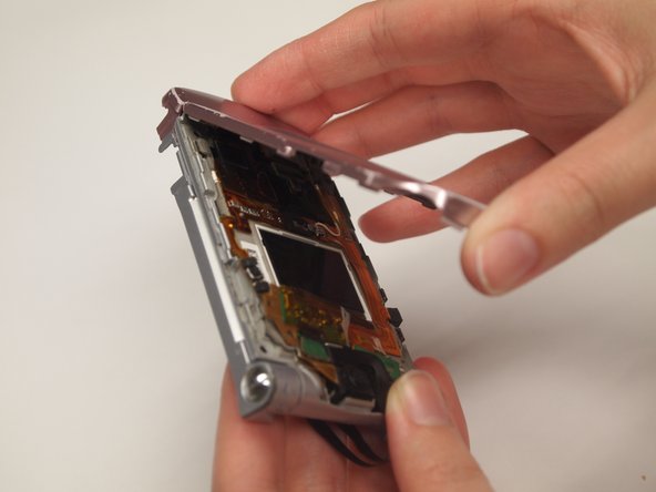

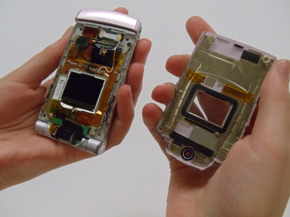

  4. Sanyo Katana Screen Replacement, Front Case: crwdns2935265:04crwdnd2935265:01crwdnd2935265:03crwdne2935265:0 Sanyo Katana Screen Replacement, Front Case: crwdns2935265:04crwdnd2935265:02crwdnd2935265:03crwdne2935265:0 Sanyo Katana Screen Replacement, Front Case: crwdns2935265:04crwdnd2935265:03crwdnd2935265:03crwdne2935265:0
    • Use the spudger to pry off the front case from the left and right sides of the device.
    • Once it has popped off, pull the casing apart with fingers.

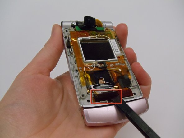

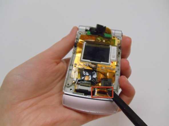

  6. Sanyo Katana Screen Replacement: crwdns2935265:06crwdnd2935265:01crwdnd2935265:03crwdne2935265:0 Sanyo Katana Screen Replacement: crwdns2935265:06crwdnd2935265:02crwdnd2935265:03crwdne2935265:0 Sanyo Katana Screen Replacement: crwdns2935265:06crwdnd2935265:03crwdnd2935265:03crwdne2935265:0

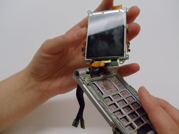

    • Use a spudger to detach all of the connections to the motherboard in the back of the phone by the screen.

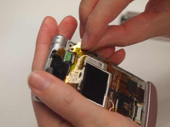

  7. Sanyo Katana Screen Replacement: crwdns2935265:07crwdnd2935265:01crwdnd2935265:02crwdne2935265:0 Sanyo Katana Screen Replacement: crwdns2935265:07crwdnd2935265:02crwdnd2935265:02crwdne2935265:0
    • Use the flat edge of the spudger to detach the screen from the phone casing.
    • Pull the screen up and away from the case.
