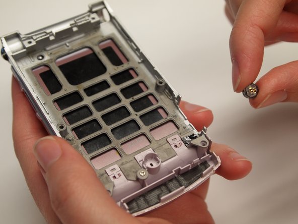

  10. Sanyo Katana Microphone Replacement, Microphone: crwdns2935265:010crwdnd2935265:01crwdnd2935265:02crwdne2935265:0 Sanyo Katana Microphone Replacement, Microphone: crwdns2935265:010crwdnd2935265:02crwdnd2935265:02crwdne2935265:0
    • Use fingers to grab the microphone and remove it from its housing.
