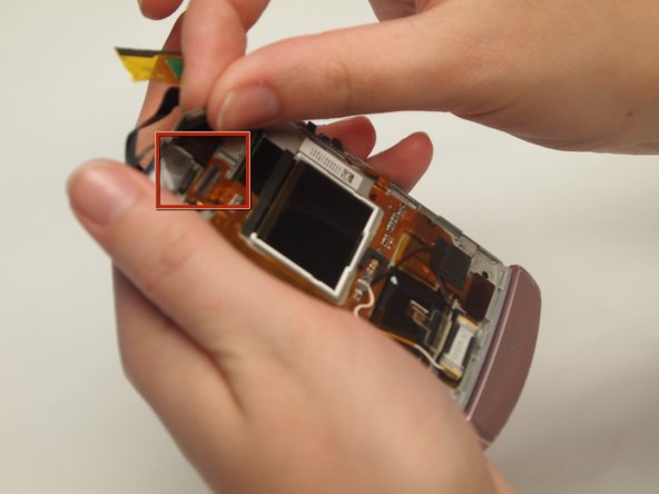

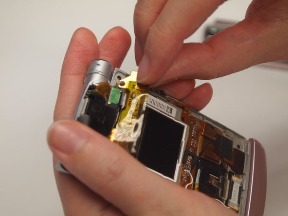

  5. Sanyo Katana Camera Replacement, Camera: crwdns2935265:05crwdnd2935265:01crwdnd2935265:03crwdne2935265:0 Sanyo Katana Camera Replacement, Camera: crwdns2935265:05crwdnd2935265:02crwdnd2935265:03crwdne2935265:0 Sanyo Katana Camera Replacement, Camera: crwdns2935265:05crwdnd2935265:03crwdnd2935265:03crwdne2935265:0
    • Use a Tri-wing Y0 screwdriver to remove the 4.4mm screw.
    • Use fingers to remove the strip.

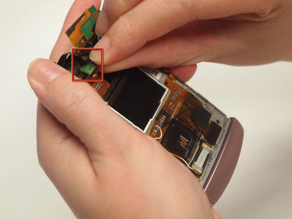

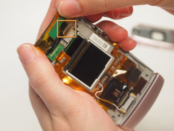

  6. Sanyo Katana Camera Replacement: crwdns2935265:06crwdnd2935265:01crwdnd2935265:03crwdne2935265:0 Sanyo Katana Camera Replacement: crwdns2935265:06crwdnd2935265:02crwdnd2935265:03crwdne2935265:0 Sanyo Katana Camera Replacement: crwdns2935265:06crwdnd2935265:03crwdnd2935265:03crwdne2935265:0
    • Detach the ribbon connections underneath the green connector strip and remove them from the device. This will reveal the camera.

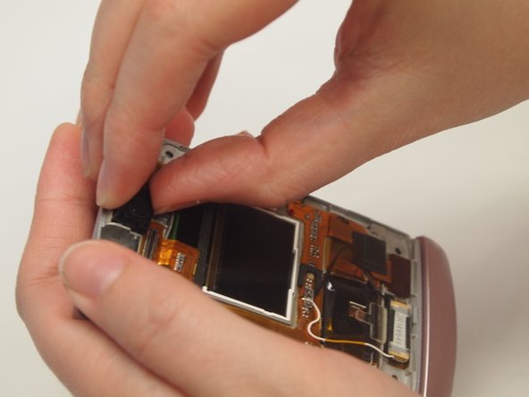

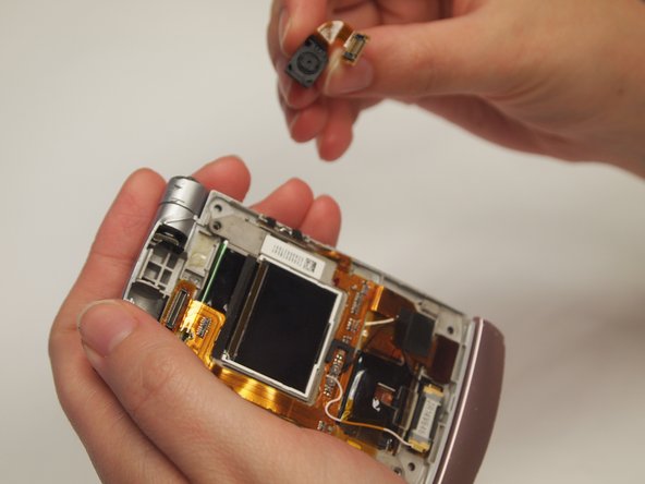

    • Using a spudger, remove the ribbon connection of the camera from the adhesive that attaches it to the device.
    • Grab the camera using fingers and remove it from the phone case.
