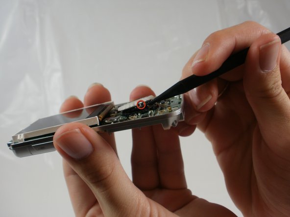

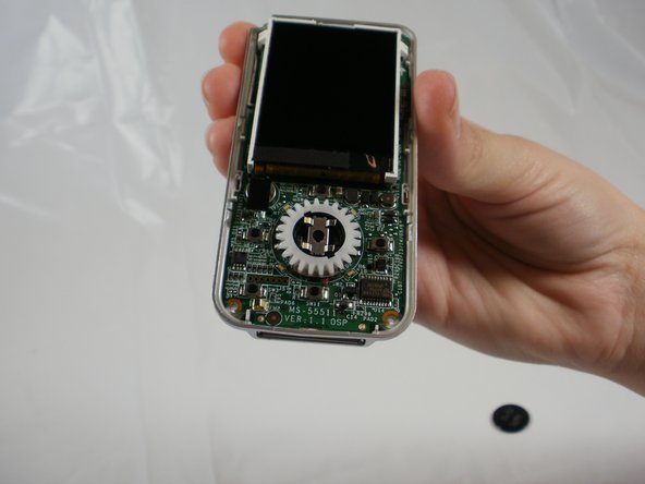

  8. Sansa e260R Scroll Wheel Replacement, Scroll Wheel: crwdns2935265:08crwdnd2935265:01crwdnd2935265:02crwdne2935265:0 Sansa e260R Scroll Wheel Replacement, Scroll Wheel: crwdns2935265:08crwdnd2935265:02crwdnd2935265:02crwdne2935265:0
    • Gently pry the bottom of the black button to remove it from the device.
  9. Sansa e260R Scroll Wheel Replacement: crwdns2935265:09crwdnd2935265:01crwdnd2935265:02crwdne2935265:0 Sansa e260R Scroll Wheel Replacement: crwdns2935265:09crwdnd2935265:02crwdnd2935265:02crwdne2935265:0
    • There are 4 small metal hooks under the white scrolling mechanism.
    • To remove the white scrolling mechanism, remove two of the bottom hooks using a spudger.
  10. Sansa e260R Scroll Wheel Replacement: crwdns2935265:010crwdnd2935265:01crwdnd2935265:01crwdne2935265:0
    • Clean the area around the button to remove any dirt or other outside material that would prevent the scroll wheel from moving freely.

Thanks very much for this guide. I used it to expose and clean my Sansa scroll wheel which is now functioning much better.
