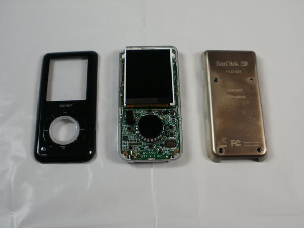

    1. Sansa e260R Memory Board Replacement, Rear Case: crwdns2935265:01crwdnd2935265:01crwdnd2935265:01crwdne2935265:0
      • Before disassembling the device, make sure it is powered off.
      • Remove the four 1.5mm screws on the back of the device.
    2. Sansa e260R Memory Board Replacement: crwdns2935265:02crwdnd2935265:01crwdnd2935265:01crwdne2935265:0
      • Using a plastic opening tool, lift the metal backing from the front of the device.
    3. Sansa e260R Memory Board Replacement: crwdns2935265:03crwdnd2935265:01crwdnd2935265:01crwdne2935265:0
      • Pull the rear panel off of the Sansa e260R.

    1. Sansa e260R Memory Board Replacement, Front Panel: crwdns2935265:05crwdnd2935265:01crwdnd2935265:01crwdne2935265:0
      • Remove the four 1.5mm screws on the inner casing of the device.
      • These screws are very small and hard to extract from the casing. It may be helpful to use a magnetic screwdriver.
    2. Sansa e260R Memory Board Replacement: crwdns2935265:06crwdnd2935265:01crwdnd2935265:01crwdne2935265:0
      • Flip the device so that the front is facing you.
      • Slide a plastic opening tool between the plastic front cover and the metal back cover of the device.
    3. Sansa e260R Memory Board Replacement: crwdns2935265:07crwdnd2935265:01crwdnd2935265:02crwdne2935265:0 Sansa e260R Memory Board Replacement: crwdns2935265:07crwdnd2935265:02crwdnd2935265:02crwdne2935265:0
      • Pull the front cover away from the rest of the device.

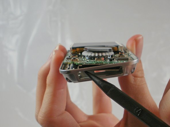

    1. Sansa e260R Memory Board Replacement, Memory Board: crwdns2935265:08crwdnd2935265:01crwdnd2935265:02crwdne2935265:0 Sansa e260R Memory Board Replacement, Memory Board: crwdns2935265:08crwdnd2935265:02crwdnd2935265:02crwdne2935265:0
      • Near the charging port, pull the case away from the motherboard to create clearance to remove the motherboard.
      • Use the spudger to push the motherboard in and pop the metal edge of the charging port up and inside the plastic case.
    2. Sansa e260R Memory Board Replacement: crwdns2935265:09crwdnd2935265:01crwdnd2935265:01crwdne2935265:0
      • Pull the bottom of the motherboard up and then out.
    3. Sansa e260R Memory Board Replacement: crwdns2935265:010crwdnd2935265:01crwdnd2935265:01crwdne2935265:0
