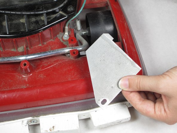

  5. Sanitaire SC684 front wheel replacement: crwdns2935265:05crwdnd2935265:01crwdnd2935265:02crwdne2935265:0 Sanitaire SC684 front wheel replacement: crwdns2935265:05crwdnd2935265:02crwdnd2935265:02crwdne2935265:0
    • Remove the small metal plate with the black bolt in the center and the larger gray plate from both sides.

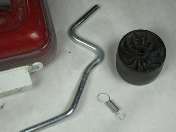

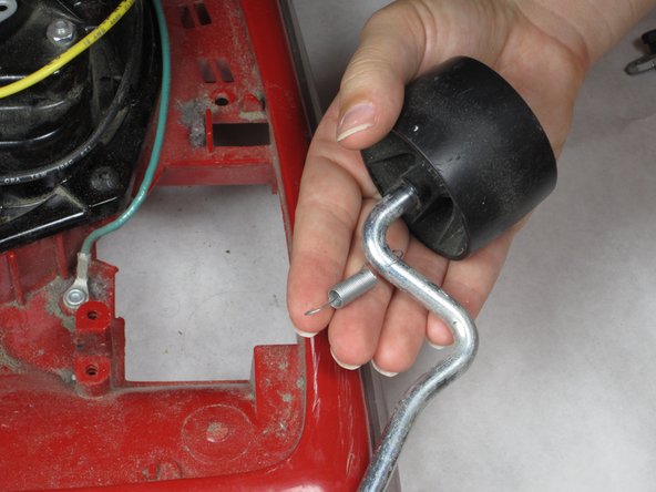

    • Pull out the silver bar that holds the two wheels to the vacuum body and detach the small spring from the vacuum body.
  7. Sanitaire SC684 front wheel replacement: crwdns2935265:07crwdnd2935265:01crwdnd2935265:02crwdne2935265:0 Sanitaire SC684 front wheel replacement: crwdns2935265:07crwdnd2935265:02crwdnd2935265:02crwdne2935265:0
    • Remove the wheel from the side with the spring by pulling it off the axel and slide off the spring, as it will be needed for the replacement front wheels.
