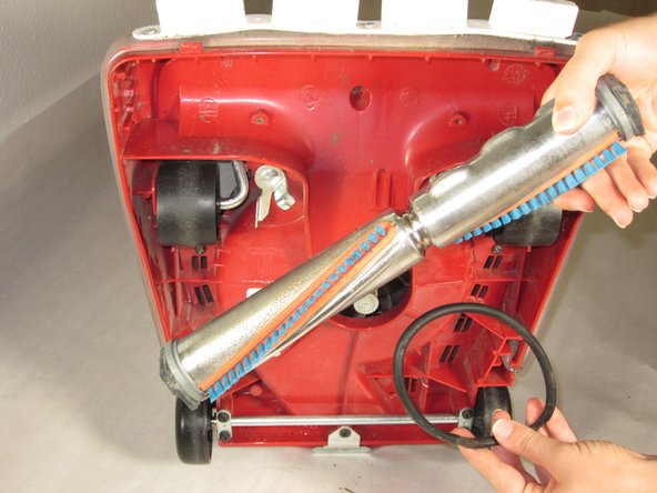

Sanitaire SC684 Roller Brusher and Drive Belt Replacement
  1. Sanitaire SC684 Roller Brusher and Drive Belt Replacement, Roller Brush and Belt: crwdns2935265:01crwdnd2935265:01crwdnd2935265:01crwdne2935265:0
    • Be sure to unplug the vacuum cleaner before disassembling to prevent electric shock.
    • Lay the vacuum on its back.
  2. Sanitaire SC684 Roller Brusher and Drive Belt Replacement: crwdns2935265:02crwdnd2935265:01crwdnd2935265:01crwdne2935265:0
    • Find the metal plate (located directly in the center).
    • Locate the two latches on either side of the metal plate.
    • Detach the latches by pulling them away from metal plate.
  3. Sanitaire SC684 Roller Brusher and Drive Belt Replacement: crwdns2935265:03crwdnd2935265:01crwdnd2935265:01crwdne2935265:0
    • Remove the metal plate by pulling it towards you.
  4. Sanitaire SC684 Roller Brusher and Drive Belt Replacement: crwdns2935265:04crwdnd2935265:01crwdnd2935265:01crwdne2935265:0
    • Identify the belt and brush roller.
    • The belt is a black ring made of rubber.
    • The brush roller is the long metal tube with bristles attached to it.
  5. Sanitaire SC684 Roller Brusher and Drive Belt Replacement: crwdns2935265:05crwdnd2935265:01crwdnd2935265:01crwdne2935265:0
    • Remove the belt from the circular knob by inserting your fingers on either side, gently lifting towards you.
  6. Sanitaire SC684 Roller Brusher and Drive Belt Replacement: crwdns2935265:06crwdnd2935265:01crwdnd2935265:02crwdne2935265:0 Sanitaire SC684 Roller Brusher and Drive Belt Replacement: crwdns2935265:06crwdnd2935265:02crwdnd2935265:02crwdne2935265:0
    • Pull the brush roller out and slip the belt off from the indent in the middle of the roller.
