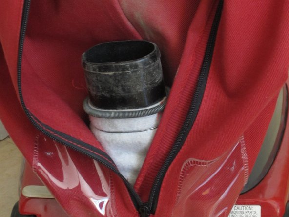

    • Be sure to unplug vacuum before disassembling to prevent electric shock.
    • Unzip the red bag.
  2. Sanitaire SC684 Bag Liner Replacement: crwdns2935265:02crwdnd2935265:01crwdnd2935265:01crwdne2935265:0
    • Identify the white bag liner in the red bag.
    • Behind the white bag liner, locate the hose connecting the white bag liner and the suction hole.
  3. Sanitaire SC684 Bag Liner Replacement: crwdns2935265:03crwdnd2935265:01crwdnd2935265:02crwdne2935265:0 Sanitaire SC684 Bag Liner Replacement: crwdns2935265:03crwdnd2935265:02crwdnd2935265:02crwdne2935265:0
    • Roll down the spring coil to remove the white bag liner.
    • Remove the white bag liner from the red bag by pulling upwards firmly and it will detach from the black tube.
    • Throw away white bag liner.
  4. Sanitaire SC684 Bag Liner Replacement: crwdns2935265:04crwdnd2935265:01crwdnd2935265:01crwdne2935265:0
    • Replace white bag liner
