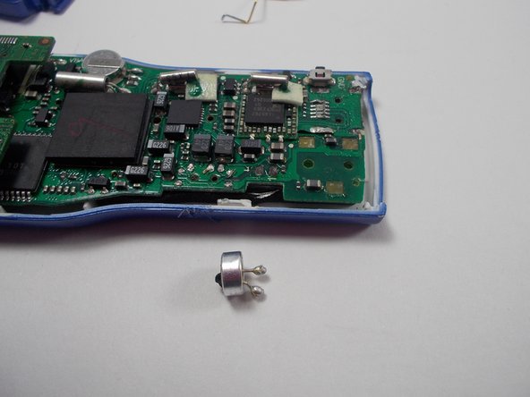

  7. Sandisk Sansa m230 Series mp3 player Microphone Replacement, Microphone: crwdns2935265:07crwdnd2935265:01crwdnd2935265:01crwdne2935265:0
    • Locate microphone on motherboard.
  8. Sandisk Sansa m230 Series mp3 player Microphone Replacement: crwdns2935265:08crwdnd2935265:01crwdnd2935265:01crwdne2935265:0
    • Find where microphone is connected to motherboard via solder.

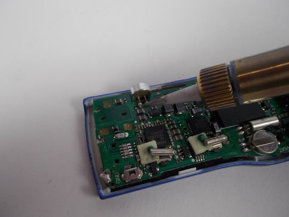

  9. Sandisk Sansa m230 Series mp3 player Microphone Replacement: crwdns2935265:09crwdnd2935265:01crwdnd2935265:02crwdne2935265:0 Sandisk Sansa m230 Series mp3 player Microphone Replacement: crwdns2935265:09crwdnd2935265:02crwdnd2935265:02crwdne2935265:0
    • Use the soldering iron to liquefy the solder connecting the microphone to the motherboard.
  10. Sandisk Sansa m230 Series mp3 player Microphone Replacement: crwdns2935265:010crwdnd2935265:01crwdnd2935265:01crwdne2935265:0
    • The solder and soldering iron will be very hot at this time. Do not touch unless wearing protective gloves as you will be burnt.
    • When not in use, be sure to always elevate the hot end of the soldering iron on a metal stand to prevent incidental burns.

    • Remove the faulty microphone as you heat and melt the soldering points.
  12. Sandisk Sansa m230 Series mp3 player Microphone Replacement: crwdns2935265:012crwdnd2935265:01crwdnd2935265:01crwdne2935265:0
    • Replace the faulty microphone with a new one in working order.

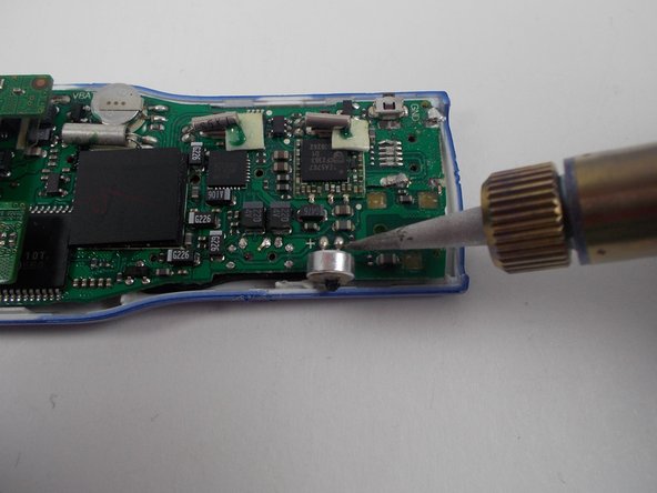

  13. Sandisk Sansa m230 Series mp3 player Microphone Replacement: crwdns2935265:013crwdnd2935265:01crwdnd2935265:02crwdne2935265:0 Sandisk Sansa m230 Series mp3 player Microphone Replacement: crwdns2935265:013crwdnd2935265:02crwdnd2935265:02crwdne2935265:0
    • With the new microphone in place, use the soldering iron and solder to create a stable connection between the motherboard and microphone.
    • Give the new solder time to cool and harden.
