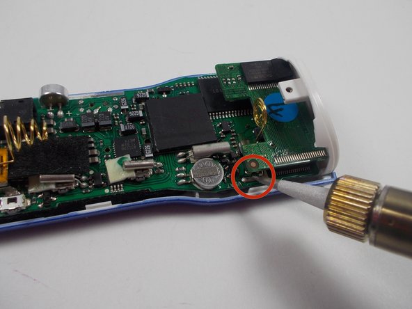

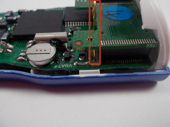

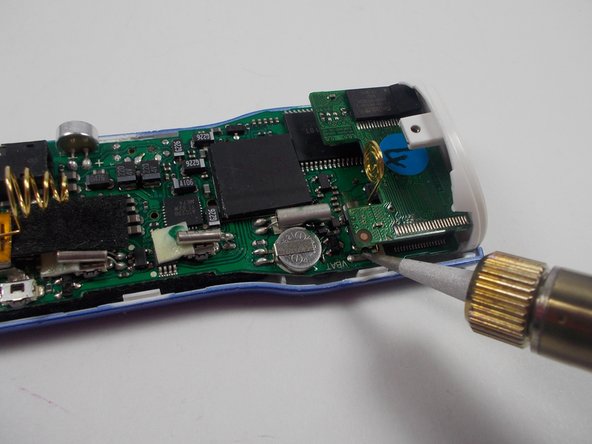

  7. Sandisk Sansa m230 Series mp3 player Battery Spring Contacts Replacement, Battery Spring Contacts: crwdns2935265:07crwdnd2935265:01crwdnd2935265:02crwdne2935265:0 Sandisk Sansa m230 Series mp3 player Battery Spring Contacts Replacement, Battery Spring Contacts: crwdns2935265:07crwdnd2935265:02crwdnd2935265:02crwdne2935265:0
    • Locate both battery spring contacts, if necessary, on the motherboard.
  8. Sandisk Sansa m230 Series mp3 player Battery Spring Contacts Replacement: crwdns2935265:08crwdnd2935265:01crwdnd2935265:02crwdne2935265:0 Sandisk Sansa m230 Series mp3 player Battery Spring Contacts Replacement: crwdns2935265:08crwdnd2935265:02crwdnd2935265:02crwdne2935265:0
    • Apply heated soldering iron to points where the contacts are soldered to the motherboard.

  10. Sandisk Sansa m230 Series mp3 player Battery Spring Contacts Replacement: crwdns2935265:010crwdnd2935265:01crwdnd2935265:01crwdne2935265:0
    • With solder melted, remove battery spring contacts from the motherboard.
  11. Sandisk Sansa m230 Series mp3 player Battery Spring Contacts Replacement: crwdns2935265:011crwdnd2935265:01crwdnd2935265:01crwdne2935265:0
    • Replace spring contacts with new ones.
  12. Sandisk Sansa m230 Series mp3 player Battery Spring Contacts Replacement: crwdns2935265:012crwdnd2935265:01crwdnd2935265:01crwdne2935265:0
    • There may be some solder in the way of the spring contacts' metal contacts. If this occurs simply melt the solder to create room for the contacts.
  13. Sandisk Sansa m230 Series mp3 player Battery Spring Contacts Replacement: crwdns2935265:013crwdnd2935265:01crwdnd2935265:02crwdne2935265:0 Sandisk Sansa m230 Series mp3 player Battery Spring Contacts Replacement: crwdns2935265:013crwdnd2935265:02crwdnd2935265:02crwdne2935265:0
    • With the new battery spring contacts in place, use the soldering iron to apply new solder to the connection points.
    • Be sure to allow the new solder to cool and harden.
