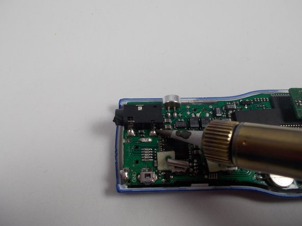

    • Locate the headphone jack on the motherboard.
  8. Sandisk Sansa m230 Series MP3 Player Headphone Jack Replacement: crwdns2935265:08crwdnd2935265:01crwdnd2935265:01crwdne2935265:0
    • Ensure the hot end of the soldering iron is elevated on a metal stand when not in use to prevent burns.
    • The solder and soldering iron are very hot! Do not touch unless you are wearing appropriate protective gloves.
  9. Sandisk Sansa m230 Series MP3 Player Headphone Jack Replacement: crwdns2935265:09crwdnd2935265:01crwdnd2935265:03crwdne2935265:0 Sandisk Sansa m230 Series MP3 Player Headphone Jack Replacement: crwdns2935265:09crwdnd2935265:02crwdnd2935265:03crwdne2935265:0 Sandisk Sansa m230 Series MP3 Player Headphone Jack Replacement: crwdns2935265:09crwdnd2935265:03crwdnd2935265:03crwdne2935265:0

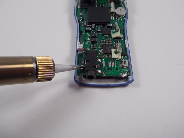

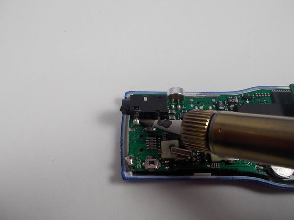

    • Use soldering iron to melt the existing solder at the three headphone jack connections.
  10. Sandisk Sansa m230 Series MP3 Player Headphone Jack Replacement: crwdns2935265:010crwdnd2935265:01crwdnd2935265:01crwdne2935265:0
    • Remove the faulty headphone jack from the motherboard.

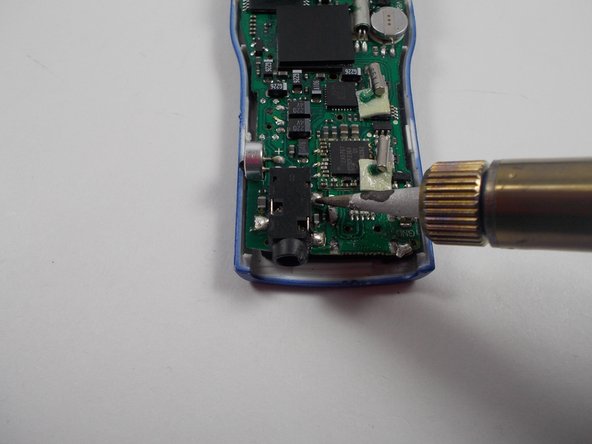

  11. Sandisk Sansa m230 Series MP3 Player Headphone Jack Replacement: crwdns2935265:011crwdnd2935265:01crwdnd2935265:01crwdne2935265:0
    • Align the new headphone jack appropriately on the motherboard for soldering.
  12. Sandisk Sansa m230 Series MP3 Player Headphone Jack Replacement: crwdns2935265:012crwdnd2935265:01crwdnd2935265:03crwdne2935265:0 Sandisk Sansa m230 Series MP3 Player Headphone Jack Replacement: crwdns2935265:012crwdnd2935265:02crwdnd2935265:03crwdne2935265:0 Sandisk Sansa m230 Series MP3 Player Headphone Jack Replacement: crwdns2935265:012crwdnd2935265:03crwdnd2935265:03crwdne2935265:0
    • Use the soldering iron and solder to create three stable connections between the motherboard and the headphone jack.
    • Allow the new solder to cool and harden before reassembling the MP3 player.
