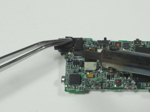

    • Flip the device over. In one corner, there is a large black component extending past the side of the device. This is the headphone jack.
    • Using a soldering iron, desolder the four points at which the headphone jack connects to the motherboard.

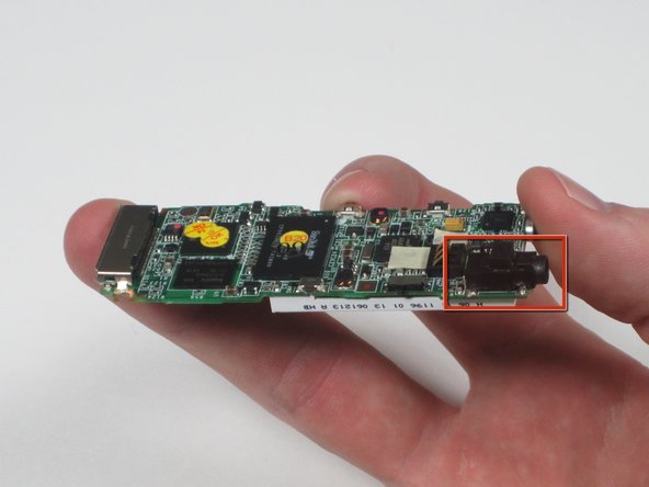

    • Resolder the new headphone jack to the motherboard, being careful that it is fully attached and in place.
    • Dimensions for headphone jack: 0.230" by 0.541" 1/8" diameter
    • The red box displays the newly installed headphone jack.

Sometimes the problem isn't that you need to solder a new jack on but that the jack has become detached from the board or worse the board has started to flake apart (the pad has detached from the board).
So get out your volt meter before you remove the old jack and test to make sure it's the jack that is the problem. My experience is that it is rarely the jack (I've fixed several of these).
There are a couple places on the board where you can solder wires onto if the pads become detached. Just be sure to glue the jack down since the pads aren't anchoring it now (so you don't put added strain on the remaining pads).
