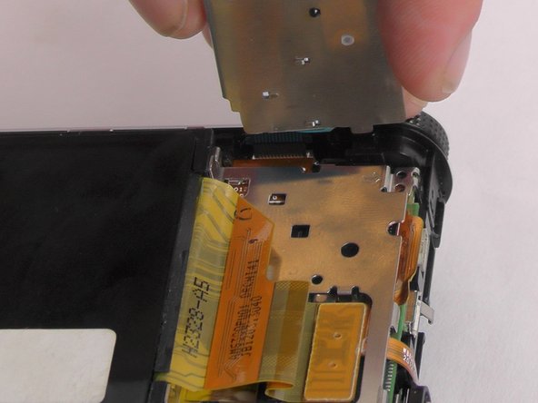

      • Use the screwdriver to remove the small silver screw holding down the control panel (located on the bottom right next to the screen).
      • Use the blue opening tool to lift up the control panel from where the screw was just removed.
    4. Samsung WB850F Screen Replacement: crwdns2935265:04crwdnd2935265:01crwdnd2935265:01crwdne2935265:0
      • Use the tweezers to gently pull the yellow control board ribbon cable out of its connector.
      • The display cable stands straight up and pops out easily. Pull up on it to remove the screen from the camera.
    5. Samsung WB850F Screen Replacement: crwdns2935265:05crwdnd2935265:01crwdnd2935265:01crwdne2935265:0
      • Connect the new screen by gently pressing the display cable on to its connector (on the motherboard).
      • When reinserting the control board, make sure the top of the control board is under the lip before screwing it in place.
