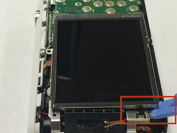

    1. Samsung WB35F Screen Replacement, Screen: crwdns2935265:04crwdnd2935265:01crwdnd2935265:03crwdne2935265:0 Samsung WB35F Screen Replacement, Screen: crwdns2935265:04crwdnd2935265:02crwdnd2935265:03crwdne2935265:0 Samsung WB35F Screen Replacement, Screen: crwdns2935265:04crwdnd2935265:03crwdnd2935265:03crwdne2935265:0
      • Open all the screws around the screen using Phillips #000 Screwdriver.

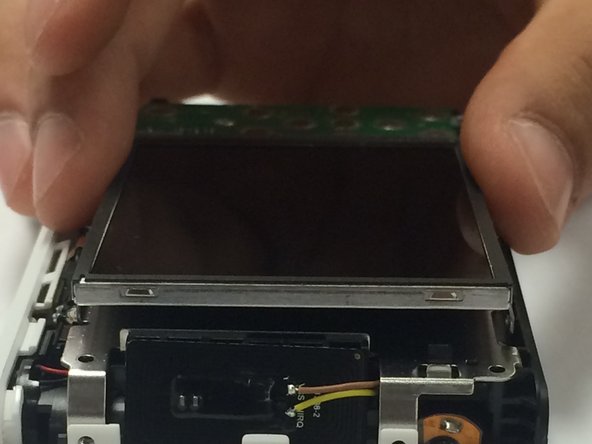

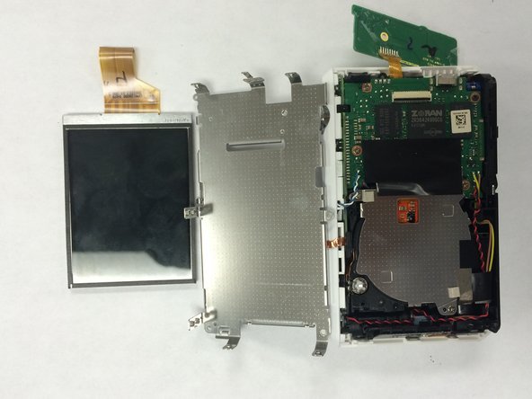

    2. Samsung WB35F Screen Replacement: crwdns2935265:05crwdnd2935265:01crwdnd2935265:02crwdne2935265:0 Samsung WB35F Screen Replacement: crwdns2935265:05crwdnd2935265:02crwdnd2935265:02crwdne2935265:0
      • First disconnect the ribbon by using spudger.
      • Carefully take out the old screen and replace it with a new screen.
      • Be careful when you pull out the screen, because there is a ribbon attached to the panel.
