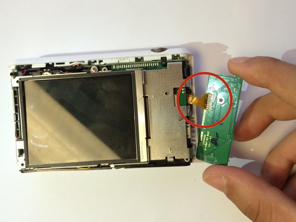

    1. Samsung WB35F Menu/Control Buttons  Replacement, Menu/Control Buttons: crwdns2935265:04crwdnd2935265:01crwdnd2935265:02crwdne2935265:0 Samsung WB35F Menu/Control Buttons  Replacement, Menu/Control Buttons: crwdns2935265:04crwdnd2935265:02crwdnd2935265:02crwdne2935265:0
      • Carefully unplug the ribbon from the Menu/Control board.
    2. Samsung WB35F Menu/Control Buttons  Replacement: crwdns2935265:05crwdnd2935265:01crwdnd2935265:01crwdne2935265:0
      • Once you unplug the ribbon. Take out the old board and replace it with new menu/control board.
