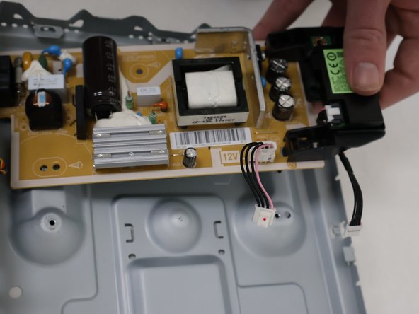

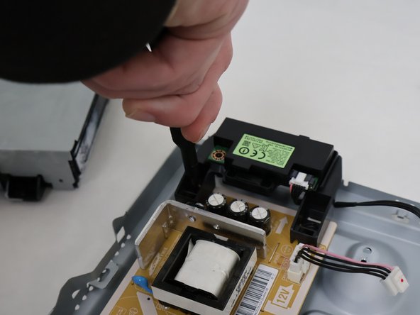

  5. Samsung UBD-M8500 Wi-Fi Module Replacement, Wi-Fi Module: crwdns2935265:05crwdnd2935265:01crwdnd2935265:01crwdne2935265:0
    • Looking at the device with the cover removed you should see a black piece with a green sticker on it, that is the Wi-Fi module.

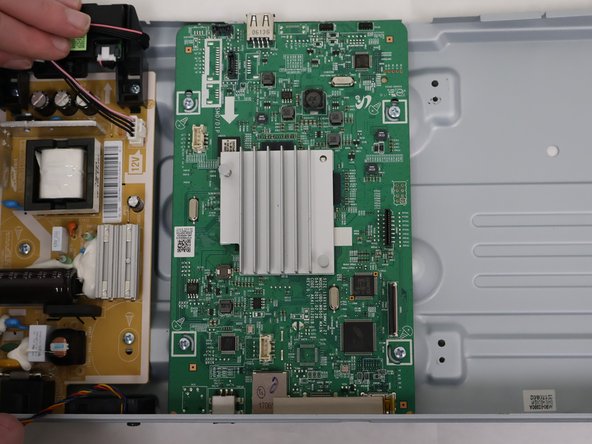

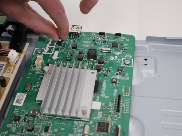

  6. Samsung UBD-M8500 Wi-Fi Module Replacement: crwdns2935265:06crwdnd2935265:01crwdnd2935265:03crwdne2935265:0 Samsung UBD-M8500 Wi-Fi Module Replacement: crwdns2935265:06crwdnd2935265:02crwdnd2935265:03crwdne2935265:0 Samsung UBD-M8500 Wi-Fi Module Replacement: crwdns2935265:06crwdnd2935265:03crwdnd2935265:03crwdne2935265:0
    • Pull the Wi-Fi module's connector directly out of its motherboard connection.

    • Remove the four screws from the Wi-Fi module using the Phillips #1 screwdriver.
    • Be mindful of the two hidden screws in the gaps of the black plastic piece.
