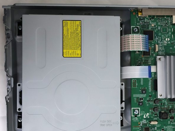

  5. Samsung UBD-M8500 Optical Drive Replacement, Optical Drive: crwdns2935265:05crwdnd2935265:01crwdnd2935265:01crwdne2935265:0
    • The disc drive is located to the right of the unit, it will be a large metallic rectangular box.
  6. Samsung UBD-M8500 Optical Drive Replacement: crwdns2935265:06crwdnd2935265:01crwdnd2935265:02crwdne2935265:0 Samsung UBD-M8500 Optical Drive Replacement: crwdns2935265:06crwdnd2935265:02crwdnd2935265:02crwdne2935265:0
    • There are two blue ribbon cables located just to the right of the optical drive. Remove the cables by unhooking the thin clip on the motherboard and then pulling them gently from their sockets.
  7. Samsung UBD-M8500 Optical Drive Replacement: crwdns2935265:07crwdnd2935265:01crwdnd2935265:03crwdne2935265:0 Samsung UBD-M8500 Optical Drive Replacement: crwdns2935265:07crwdnd2935265:02crwdnd2935265:03crwdne2935265:0 Samsung UBD-M8500 Optical Drive Replacement: crwdns2935265:07crwdnd2935265:03crwdnd2935265:03crwdne2935265:0
    • Use a Phillips #1 screwdriver to remove the four screws securing the optical drive.
