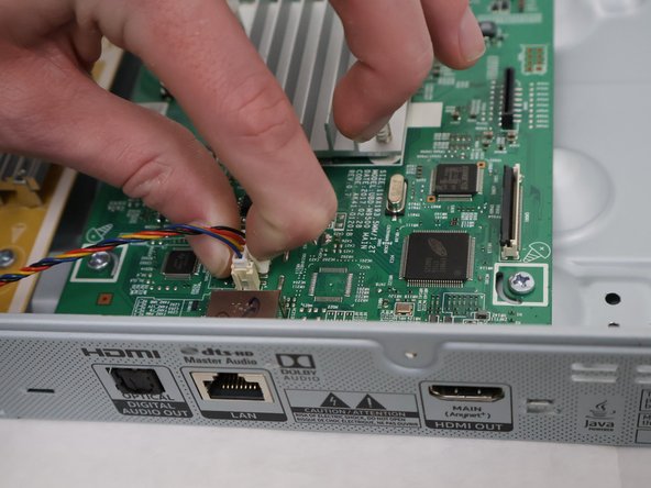

  3. Samsung UBD-M8500 Motherboard Replacement: crwdns2935265:03crwdnd2935265:01crwdnd2935265:01crwdne2935265:0
    • Using two fingers in a pinching motion, release the wire from the clip that is attached to the outer shell and disconnect it.
    • Do not pull on the wires.

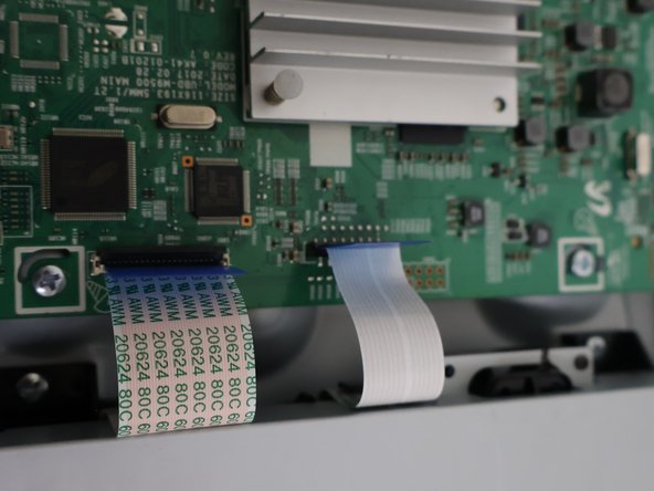

  5. Samsung UBD-M8500 Motherboard Replacement, Motherboard: crwdns2935265:05crwdnd2935265:01crwdnd2935265:02crwdne2935265:0 Samsung UBD-M8500 Motherboard Replacement, Motherboard: crwdns2935265:05crwdnd2935265:02crwdnd2935265:02crwdne2935265:0
    • Remove the two ribbon cables from the motherboard.
    • Be careful while doing so because they are fragile.

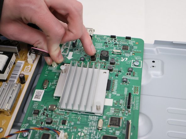

  6. Samsung UBD-M8500 Motherboard Replacement: crwdns2935265:06crwdnd2935265:01crwdnd2935265:03crwdne2935265:0 Samsung UBD-M8500 Motherboard Replacement: crwdns2935265:06crwdnd2935265:02crwdnd2935265:03crwdne2935265:0 Samsung UBD-M8500 Motherboard Replacement: crwdns2935265:06crwdnd2935265:03crwdnd2935265:03crwdne2935265:0
    • Remove the three cables on the left side.

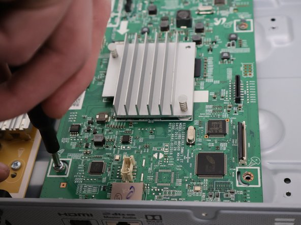

  7. Samsung UBD-M8500 Motherboard Replacement: crwdns2935265:07crwdnd2935265:01crwdnd2935265:02crwdne2935265:0 Samsung UBD-M8500 Motherboard Replacement: crwdns2935265:07crwdnd2935265:02crwdnd2935265:02crwdne2935265:0
    • Remove the four screws from the corners of the motherboard with the Phillips #1 screwdriver.
    • Lift the motherboard up and out.
