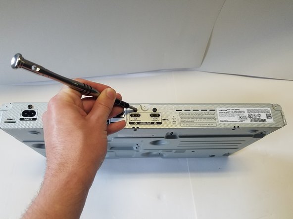

    • On the back side of the unit, remove the three 8.1mm screws marked with a Phillips #1 screwdriver.
  2. Samsung UBD-KM85C Motherboard Replacement: crwdns2935265:02crwdnd2935265:01crwdnd2935265:02crwdne2935265:0 Samsung UBD-KM85C Motherboard Replacement: crwdns2935265:02crwdnd2935265:02crwdnd2935265:02crwdne2935265:0
    • From the back, lift the case upwards away from the unit then forwards, releasing the prongs on the front.

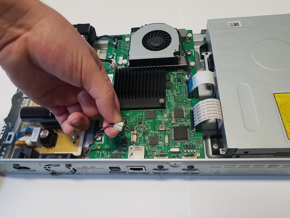

    • There is one group of wires located towards the front of the case and attached directly to the motherboard and the case. Using two fingers in a pinching motion, release the wire from the clip and disconnect it.

  5. Samsung UBD-KM85C Motherboard Replacement, Fan A: crwdns2935265:05crwdnd2935265:01crwdnd2935265:01crwdne2935265:0
    • Fan A is located on top of the motherboard and is screwed into a stand by two 6.5mm screws. The stand is also connected to the motherboard.

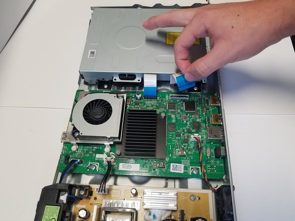

  7. Samsung UBD-KM85C Motherboard Replacement: crwdns2935265:07crwdnd2935265:01crwdnd2935265:03crwdne2935265:0 Samsung UBD-KM85C Motherboard Replacement: crwdns2935265:07crwdnd2935265:02crwdnd2935265:03crwdne2935265:0 Samsung UBD-KM85C Motherboard Replacement: crwdns2935265:07crwdnd2935265:03crwdnd2935265:03crwdne2935265:0
    • There is one wire connecting the fan to the motherboard that must be unplugged in order to release it. To unplug, use your fingers to pinch the white clip at the end and gently pull upwards to release.
  8. Samsung UBD-KM85C Motherboard Replacement: crwdns2935265:08crwdnd2935265:01crwdnd2935265:01crwdne2935265:0
    • The fan can now be lifted from the stand.

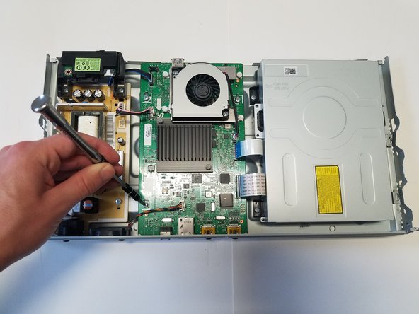

  9. Samsung UBD-KM85C Motherboard Replacement, Motherboard: crwdns2935265:09crwdnd2935265:01crwdnd2935265:01crwdne2935265:0
    • The motherboard is in the middle of the device and has all wires and connections of the device components running to it.
    • Remove the fan located on top of it.
  10. Samsung UBD-KM85C Motherboard Replacement: crwdns2935265:010crwdnd2935265:01crwdnd2935265:03crwdne2935265:0 Samsung UBD-KM85C Motherboard Replacement: crwdns2935265:010crwdnd2935265:02crwdnd2935265:03crwdne2935265:0 Samsung UBD-KM85C Motherboard Replacement: crwdns2935265:010crwdnd2935265:03crwdnd2935265:03crwdne2935265:0
    • Disconnect the wires from the motherboard.
