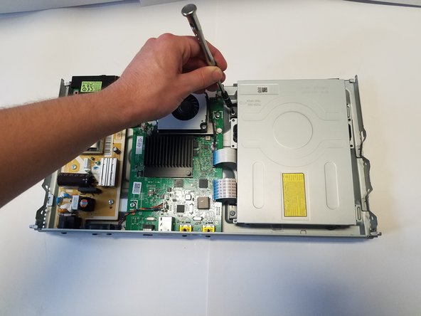

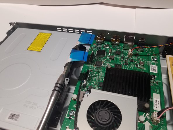

    • The disk drive has four 6.5mm screws located near each of its corners that hold it onto the frame. Use a #1 Phillips head screwdriver to remove these screws.
  7. Samsung UBD-KM85C Disc Drive Replacement: crwdns2935265:07crwdnd2935265:01crwdnd2935265:03crwdne2935265:0 Samsung UBD-KM85C Disc Drive Replacement: crwdns2935265:07crwdnd2935265:02crwdnd2935265:03crwdne2935265:0 Samsung UBD-KM85C Disc Drive Replacement: crwdns2935265:07crwdnd2935265:03crwdnd2935265:03crwdne2935265:0

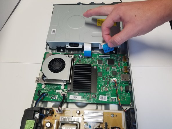

    • The disk drive has two connections to the motherboard that can be disconnected by pulling on the blue plastic tabs.
  8. Samsung UBD-KM85C Disc Drive Replacement: crwdns2935265:08crwdnd2935265:01crwdnd2935265:01crwdne2935265:0
    • Once the connections are unplugged and the screws are removed, the disk drive can be lifted out. The previous steps can be done in the reverse order to replace the part.
