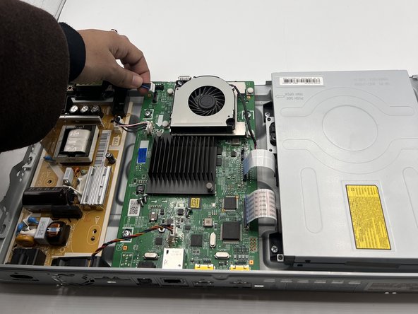

  3. Samsung UBD-K8500 Power Supply Board Replacement, Power Supply Board: crwdns2935265:03crwdnd2935265:01crwdnd2935265:02crwdne2935265:0 Samsung UBD-K8500 Power Supply Board Replacement, Power Supply Board: crwdns2935265:03crwdnd2935265:02crwdnd2935265:02crwdne2935265:0
    • Using your fingers, carefully pinch the clipping part of the two connectors and gently pull them out of their sockets.

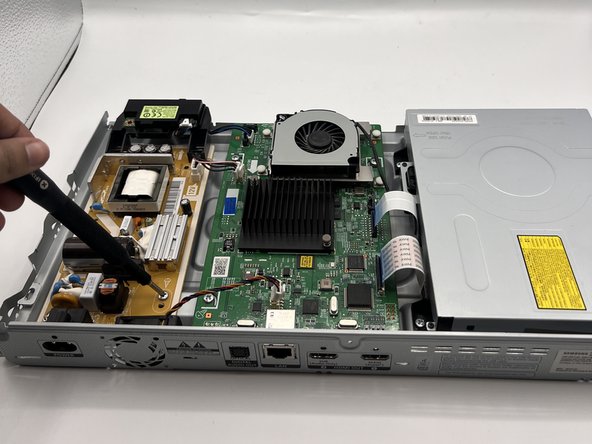

  4. Samsung UBD-K8500 Power Supply Board Replacement: crwdns2935265:04crwdnd2935265:01crwdnd2935265:02crwdne2935265:0 Samsung UBD-K8500 Power Supply Board Replacement: crwdns2935265:04crwdnd2935265:02crwdnd2935265:02crwdne2935265:0
    • Remove the four 7 mm screws from the power supply board using a Phillips #0 screwdriver.
  5. Samsung UBD-K8500 Power Supply Board Replacement: crwdns2935265:05crwdnd2935265:01crwdnd2935265:01crwdne2935265:0
    • Gently remove the power supply board.
