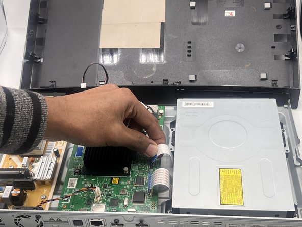

    • Carefully lift up the top panel.
    • There is a cables that must be disconnected before completely removing the panel.
    • Detach the cable connecting the top panel to the motherboard.
    • Take the top off and set it to the side.

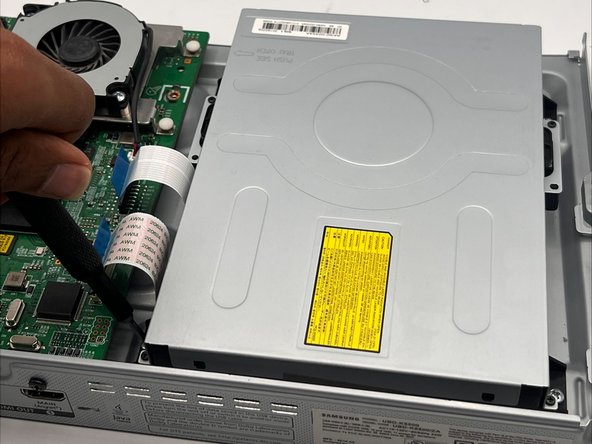

    • Find the blue tabs of the ribbon connectors, and gently pull them both out.
  4. Samsung UBD-K8500 Disc Tray Replacement: crwdns2935265:04crwdnd2935265:01crwdnd2935265:02crwdne2935265:0 Samsung UBD-K8500 Disc Tray Replacement: crwdns2935265:04crwdnd2935265:02crwdnd2935265:02crwdne2935265:0

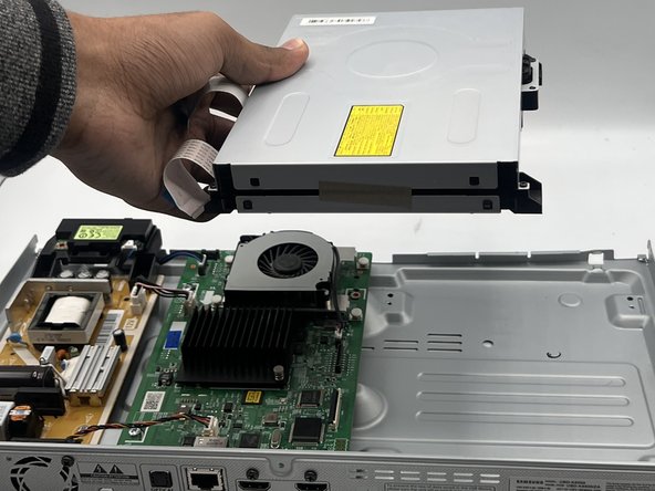

    • Remove the four 8 mm screws from the disc drive using a Phillips #0 screwdriver.
  5. Samsung UBD-K8500 Disc Tray Replacement: crwdns2935265:05crwdnd2935265:01crwdnd2935265:02crwdne2935265:0 Samsung UBD-K8500 Disc Tray Replacement: crwdns2935265:05crwdnd2935265:02crwdnd2935265:02crwdne2935265:0
    • Gently remove the disc tray.
