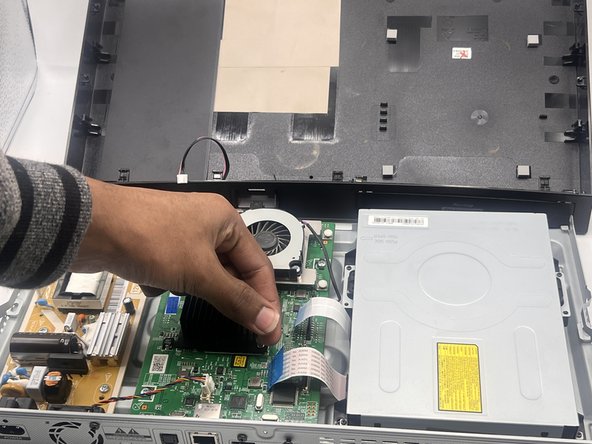

    • Remove the six 10 mm screws from the back of the unit using a Phillips #0 screwdriver.
  2. Samsung UBD-K8500 Circuit Board Replacement: crwdns2935265:02crwdnd2935265:01crwdnd2935265:02crwdne2935265:0 Samsung UBD-K8500 Circuit Board Replacement: crwdns2935265:02crwdnd2935265:02crwdnd2935265:02crwdne2935265:0

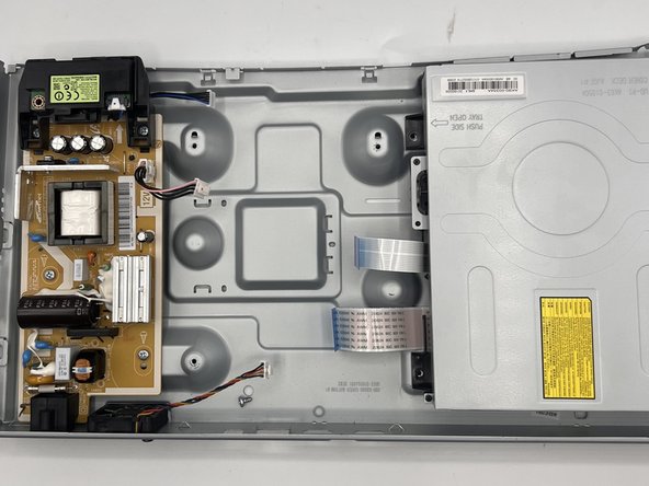

    • Carefully lift up the top panel.
    • There is a cables that must be disconnected before completely removing the panel.
    • Detach the cable connecting the top panel to the motherboard.
    • Take the top off and set it to the side.

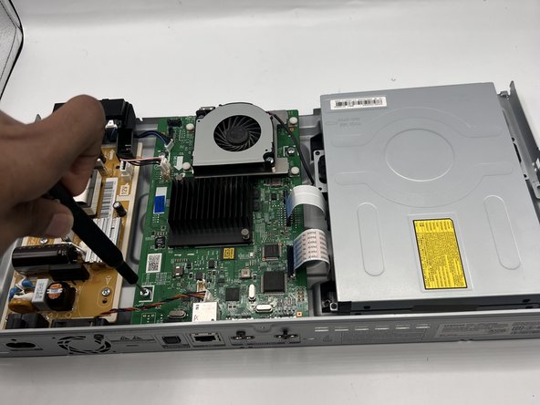

  3. Samsung UBD-K8500 Circuit Board Replacement, Circuit Board: crwdns2935265:03crwdnd2935265:01crwdnd2935265:01crwdne2935265:0
    • Using your fingers, carefully pinch the clipping part of the four connectors and gently pull them out of their sockets.
  4. Samsung UBD-K8500 Circuit Board Replacement: crwdns2935265:04crwdnd2935265:01crwdnd2935265:02crwdne2935265:0 Samsung UBD-K8500 Circuit Board Replacement: crwdns2935265:04crwdnd2935265:02crwdnd2935265:02crwdne2935265:0
    • Gently pull out the two blue tabs of the ribbon connectors.
  5. Samsung UBD-K8500 Circuit Board Replacement: crwdns2935265:05crwdnd2935265:01crwdnd2935265:02crwdne2935265:0 Samsung UBD-K8500 Circuit Board Replacement: crwdns2935265:05crwdnd2935265:02crwdnd2935265:02crwdne2935265:0
    • Remove the three 7 mm screws from the circuit board using a Phillips #0 screwdriver.
  6. Samsung UBD-K8500 Circuit Board Replacement: crwdns2935265:06crwdnd2935265:01crwdnd2935265:02crwdne2935265:0 Samsung UBD-K8500 Circuit Board Replacement: crwdns2935265:06crwdnd2935265:02crwdnd2935265:02crwdne2935265:0
    • Gently pull out the circuit board.
