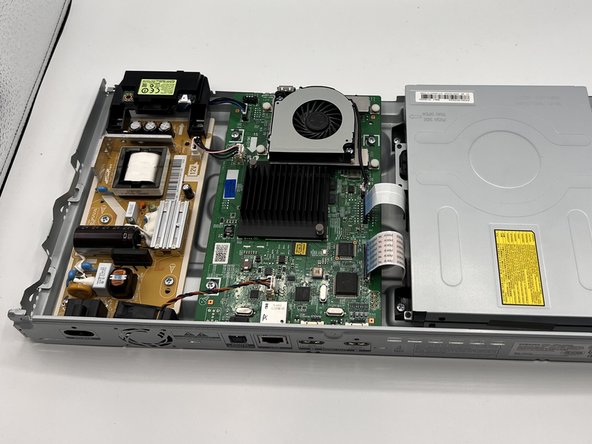

    • Remove the six 10 mm screws from the back of the unit using a Phillips #0 screwdriver.
  2. Samsung UBD-K8500 Case Fan Replacement: crwdns2935265:02crwdnd2935265:01crwdnd2935265:02crwdne2935265:0 Samsung UBD-K8500 Case Fan Replacement: crwdns2935265:02crwdnd2935265:02crwdnd2935265:02crwdne2935265:0
    • Carefully lift up the top panel.
    • There is a cables that must be disconnected before completely removing the panel.
    • Detach the cable connecting the top panel to the motherboard.
    • Take the top off and set it to the side.

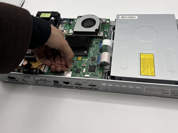

  3. Samsung UBD-K8500 Case Fan Replacement, Case Fan: crwdns2935265:03crwdnd2935265:01crwdnd2935265:02crwdne2935265:0 Samsung UBD-K8500 Case Fan Replacement, Case Fan: crwdns2935265:03crwdnd2935265:02crwdnd2935265:02crwdne2935265:0
    • Pinch and gently remove the connector from its socket.
  4. Samsung UBD-K8500 Case Fan Replacement: crwdns2935265:04crwdnd2935265:01crwdnd2935265:02crwdne2935265:0 Samsung UBD-K8500 Case Fan Replacement: crwdns2935265:04crwdnd2935265:02crwdnd2935265:02crwdne2935265:0
    • Remove the case fan.
