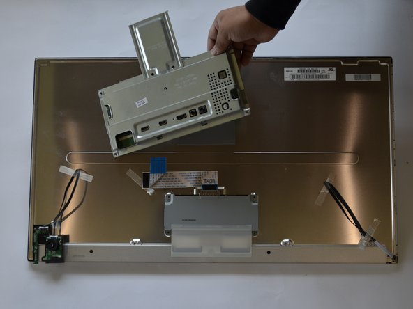

    • Flip the monitor over so that it is facedown.
    • Remove the single screw in the middle using a #2 Phillips screwdriver.
    • Remove backing to reveal signal/power board in center.
  3. Samsung U28E510 Motherboard Replacement: crwdns2935265:03crwdnd2935265:01crwdnd2935265:02crwdne2935265:0 Samsung U28E510 Motherboard Replacement: crwdns2935265:03crwdnd2935265:02crwdnd2935265:02crwdne2935265:0
    • Ensure to grip the connection plugs when removing wires to prevent damage to wires.
    • Unplug wires connected to supply (one on the left and one on right).
    • Disconnect the signal ribbon cable.
    • Pull the motherboard shield off—it's adhered in place by tape, so some force may be needed.
  4. Samsung U28E510 Motherboard Replacement: crwdns2935265:04crwdnd2935265:01crwdnd2935265:02crwdne2935265:0 Samsung U28E510 Motherboard Replacement: crwdns2935265:04crwdnd2935265:02crwdnd2935265:02crwdne2935265:0
    • Lay piece upside down.
    • Use a #2 Phillips screwdriver to remove the two screws that secure the motherboard.
    • Lift the motherboard out of the metal shield.
