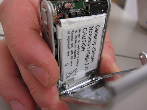

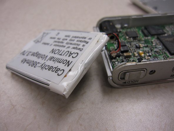

  4. Samsung TFT Color YP-T7J The Screen Replacement, The Battery: crwdns2935265:04crwdnd2935265:01crwdnd2935265:02crwdne2935265:0 Samsung TFT Color YP-T7J The Screen Replacement, The Battery: crwdns2935265:04crwdnd2935265:02crwdnd2935265:02crwdne2935265:0
    • Once the back cover has been removed the battery will be visible.
    • Pry the battery from the device.
    • NOTE: The battery should still be connected to the device

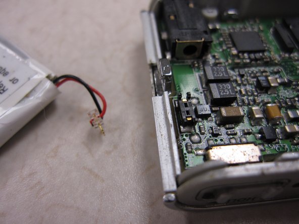

  5. Samsung TFT Color YP-T7J The Screen Replacement: crwdns2935265:05crwdnd2935265:01crwdnd2935265:02crwdne2935265:0 Samsung TFT Color YP-T7J The Screen Replacement: crwdns2935265:05crwdnd2935265:02crwdnd2935265:02crwdne2935265:0
    • Unplug the battery connecting cables.
    • NOTE: The battery now should be free from all connections to the device.

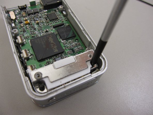

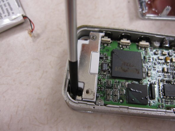

  6. Samsung TFT Color YP-T7J The Screen Replacement, Disassembling Samsung TFT Color YP-T7J USB Connector Dock: crwdns2935265:06crwdnd2935265:01crwdnd2935265:03crwdne2935265:0 Samsung TFT Color YP-T7J The Screen Replacement, Disassembling Samsung TFT Color YP-T7J USB Connector Dock: crwdns2935265:06crwdnd2935265:02crwdnd2935265:03crwdne2935265:0 Samsung TFT Color YP-T7J The Screen Replacement, Disassembling Samsung TFT Color YP-T7J USB Connector Dock: crwdns2935265:06crwdnd2935265:03crwdnd2935265:03crwdne2935265:0
    • Once the battery has been removed you can see the motherboard.
    • Unscrew 4 screws on the metal docket using a Phillips head screw driver.
    • The USB connector can now be taken off of the device.

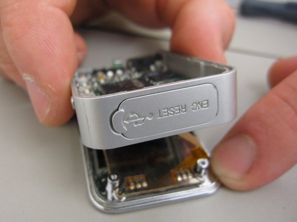

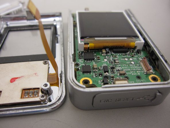

  7. Samsung TFT Color YP-T7J The Screen Replacement, The Front Cover: crwdns2935265:07crwdnd2935265:01crwdnd2935265:02crwdne2935265:0 Samsung TFT Color YP-T7J The Screen Replacement, The Front Cover: crwdns2935265:07crwdnd2935265:02crwdnd2935265:02crwdne2935265:0
    • Using the philips screwdriver, remove the two screws on the mother board.
  8. Samsung TFT Color YP-T7J The Screen Replacement: crwdns2935265:08crwdnd2935265:01crwdnd2935265:03crwdne2935265:0 Samsung TFT Color YP-T7J The Screen Replacement: crwdns2935265:08crwdnd2935265:02crwdnd2935265:03crwdne2935265:0 Samsung TFT Color YP-T7J The Screen Replacement: crwdns2935265:08crwdnd2935265:03crwdnd2935265:03crwdne2935265:0
    • Place the pry tool in-between the front cover and mother board.
    • Gently separate the front cover.

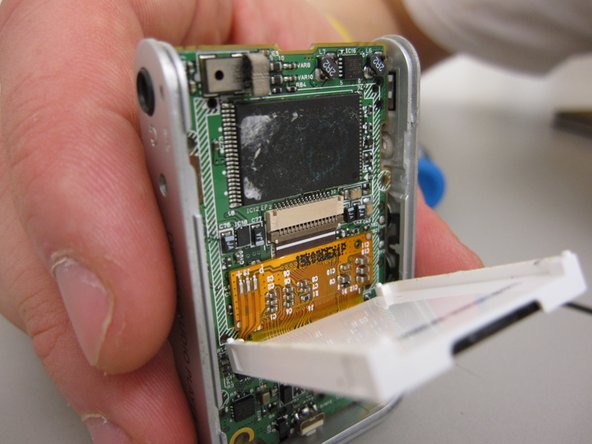

  9. Samsung TFT Color YP-T7J The Screen Replacement: crwdns2935265:09crwdnd2935265:01crwdnd2935265:01crwdne2935265:0
    • After opening the front cover you will see and electric ribbon connecting the buttons to the mother board.
  10. Samsung TFT Color YP-T7J The Screen Replacement: crwdns2935265:010crwdnd2935265:01crwdnd2935265:02crwdne2935265:0 Samsung TFT Color YP-T7J The Screen Replacement: crwdns2935265:010crwdnd2935265:02crwdnd2935265:02crwdne2935265:0
    • CAUTION: Do not rip the electric ribbon from the mother board.
    • Carefully flip up the plastic lip that holds the electric ribbon to the board.

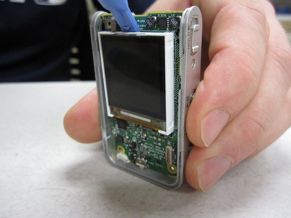

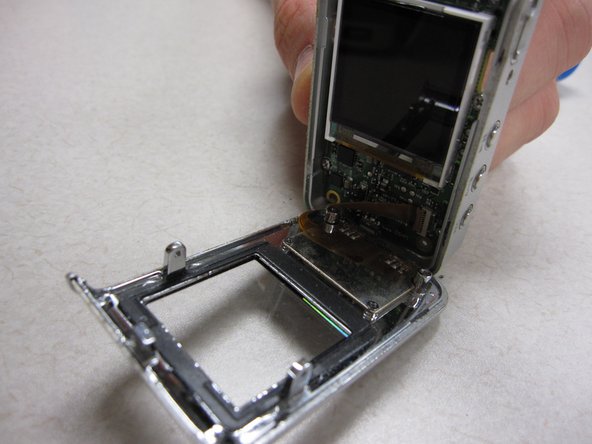

  11. Samsung TFT Color YP-T7J The Screen Replacement, The Screen: crwdns2935265:011crwdnd2935265:01crwdnd2935265:02crwdne2935265:0 Samsung TFT Color YP-T7J The Screen Replacement, The Screen: crwdns2935265:011crwdnd2935265:02crwdnd2935265:02crwdne2935265:0
    • Place the pry tool between the plastic housing around the LCD screen, and the mother board.
    • Gently separate the screen housing from the mother board
    • CAUTION: The screen is still attached to the mother board via another electric ribbon.

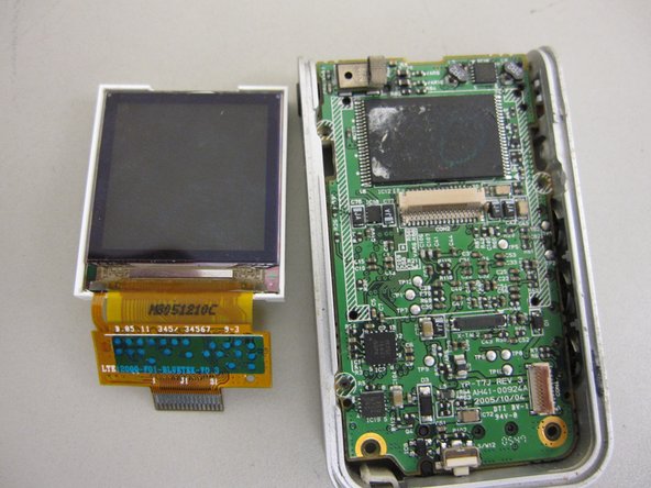

  12. Samsung TFT Color YP-T7J The Screen Replacement: crwdns2935265:012crwdnd2935265:01crwdnd2935265:02crwdne2935265:0 Samsung TFT Color YP-T7J The Screen Replacement: crwdns2935265:012crwdnd2935265:02crwdnd2935265:02crwdne2935265:0
    • Using a plastic pry tool to flip up the lip, which connects the electric ribbon to the mother board.

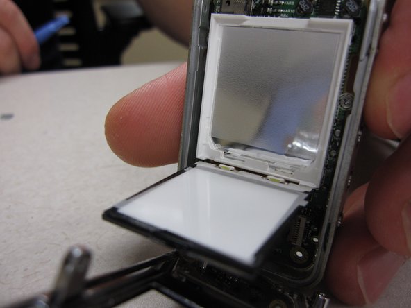

  13. Samsung TFT Color YP-T7J The Screen Replacement: crwdns2935265:013crwdnd2935265:01crwdnd2935265:02crwdne2935265:0 Samsung TFT Color YP-T7J The Screen Replacement: crwdns2935265:013crwdnd2935265:02crwdnd2935265:02crwdne2935265:0
    • Place the pry tool between the LCD screen and the white housing unit
    • Gently separate the two.
  14. Samsung TFT Color YP-T7J The Screen Replacement: crwdns2935265:014crwdnd2935265:01crwdnd2935265:02crwdne2935265:0 Samsung TFT Color YP-T7J The Screen Replacement: crwdns2935265:014crwdnd2935265:02crwdnd2935265:02crwdne2935265:0
    • Insert the new screen into the white unit.
    • Connect the LCD screen to the mother board by inserting the electric ribbon into its port, and closing the lip.
