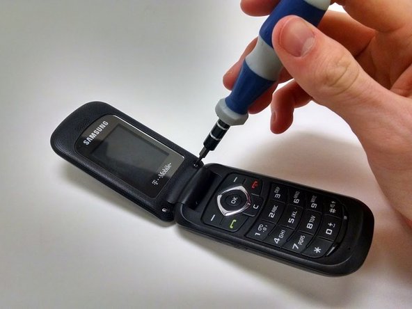

    2. Samsung T139 Screen Replacement, Remove Screws: crwdns2935265:04crwdnd2935265:01crwdnd2935265:02crwdne2935265:0 Samsung T139 Screen Replacement, Remove Screws: crwdns2935265:04crwdnd2935265:02crwdnd2935265:02crwdne2935265:0
      • Remove the two Phillips 1.0mm #0 screws

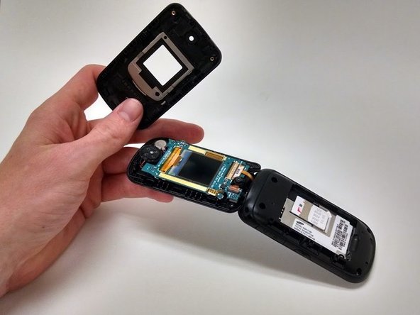

    3. Samsung T139 Screen Replacement, Remove Face Plate: crwdns2935265:05crwdnd2935265:01crwdnd2935265:03crwdne2935265:0 Samsung T139 Screen Replacement, Remove Face Plate: crwdns2935265:05crwdnd2935265:02crwdnd2935265:03crwdne2935265:0 Samsung T139 Screen Replacement, Remove Face Plate: crwdns2935265:05crwdnd2935265:03crwdnd2935265:03crwdne2935265:0
      • Using plastic opening tool, work around the face plate until it pops off

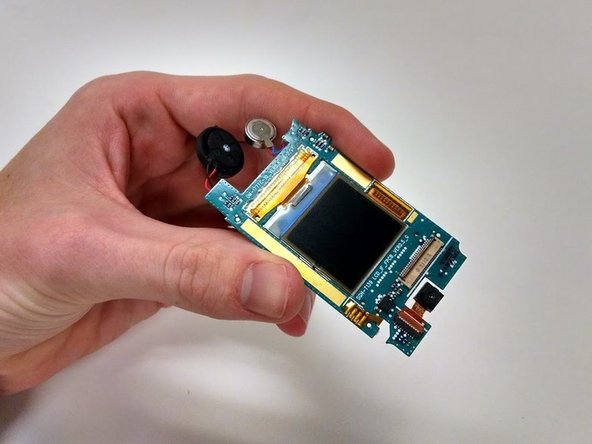

    4. Samsung T139 Screen Replacement, Remove Screen: crwdns2935265:06crwdnd2935265:01crwdnd2935265:02crwdne2935265:0 Samsung T139 Screen Replacement, Remove Screen: crwdns2935265:06crwdnd2935265:02crwdnd2935265:02crwdne2935265:0
      • Gently pull away ribbon cord
      • Lift away screen circuit board
