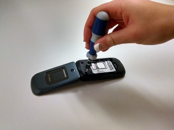

    1. Samsung T139 Pad Buttons Replacement, Remove Screws: crwdns2935265:03crwdnd2935265:01crwdnd2935265:02crwdne2935265:0 Samsung T139 Pad Buttons Replacement, Remove Screws: crwdns2935265:03crwdnd2935265:02crwdnd2935265:02crwdne2935265:0
      • Remove the four Phillips 1.0mm #0 screws

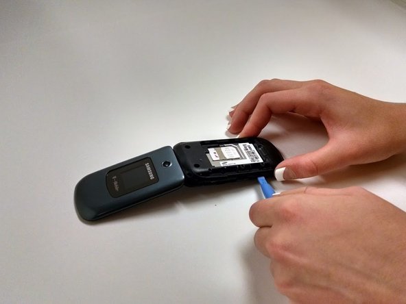

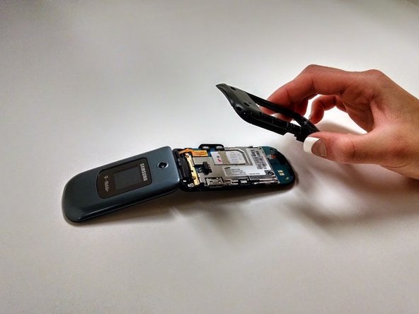

    2. Samsung T139 Pad Buttons Replacement, Remove Black Plastic Cover: crwdns2935265:04crwdnd2935265:01crwdnd2935265:03crwdne2935265:0 Samsung T139 Pad Buttons Replacement, Remove Black Plastic Cover: crwdns2935265:04crwdnd2935265:02crwdnd2935265:03crwdne2935265:0 Samsung T139 Pad Buttons Replacement, Remove Black Plastic Cover: crwdns2935265:04crwdnd2935265:03crwdnd2935265:03crwdne2935265:0
      • Using the plastic opening tool, work around the edge of the black plastic cover until it pops off

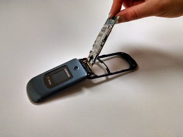

    4. Samsung T139 Pad Buttons Replacement, Remove Circuit Board: crwdns2935265:06crwdnd2935265:01crwdnd2935265:01crwdne2935265:0
      • Lift circuit board up gently
      • Be careful to not pull ribbon cord apart when removing
