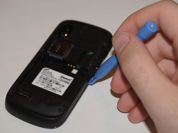

  2. Samsung Solstice Rear Facing Camera Replacement, Removing the battery: crwdns2935265:02crwdnd2935265:01crwdnd2935265:03crwdne2935265:0 Samsung Solstice Rear Facing Camera Replacement, Removing the battery: crwdns2935265:02crwdnd2935265:02crwdnd2935265:03crwdne2935265:0 Samsung Solstice Rear Facing Camera Replacement, Removing the battery: crwdns2935265:02crwdnd2935265:03crwdnd2935265:03crwdne2935265:0
    • This step can be accomplished without the need of a plastic opening tool. Just use your finger if you want to.
    • Wedge a plastic opening tool in between the rear end of the battery and the plastic frame.
    • Pry the battery up out of its recess and away from the phone.

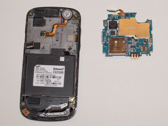

  6. Samsung Solstice Rear Facing Camera Replacement, Removing the plastic mid-frame: crwdns2935265:06crwdnd2935265:01crwdnd2935265:03crwdne2935265:0 Samsung Solstice Rear Facing Camera Replacement, Removing the plastic mid-frame: crwdns2935265:06crwdnd2935265:02crwdnd2935265:03crwdne2935265:0 Samsung Solstice Rear Facing Camera Replacement, Removing the plastic mid-frame: crwdns2935265:06crwdnd2935265:03crwdnd2935265:03crwdne2935265:0
    • Remove the six 0.4mm Phillips screws securing the midframe to the front panel assembly.
    • Grasp the the plastic midframe with your thumb and forefinger and lift it away from the phone.

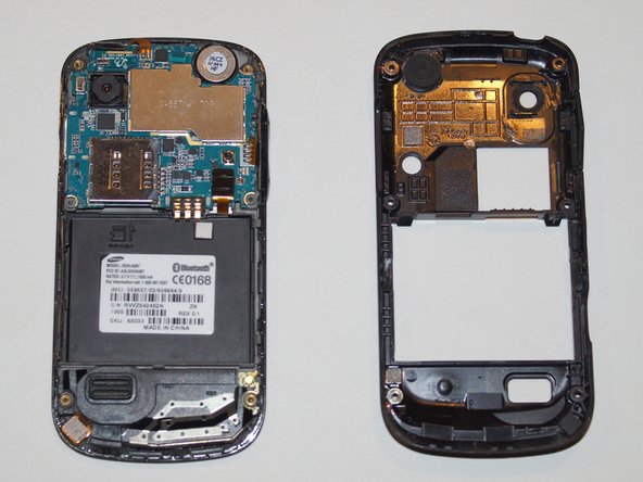

  7. Samsung Solstice Rear Facing Camera Replacement, Motherboard Assembly: crwdns2935265:07crwdnd2935265:01crwdnd2935265:02crwdne2935265:0 Samsung Solstice Rear Facing Camera Replacement, Motherboard Assembly: crwdns2935265:07crwdnd2935265:02crwdnd2935265:02crwdne2935265:0
    • Use a plastic opening tool to pry the connectors from their sockets on the motherboard.
    • Gently remove the motherboard from the phone
    • Set the motherboard aside once it is free and separated from the phone

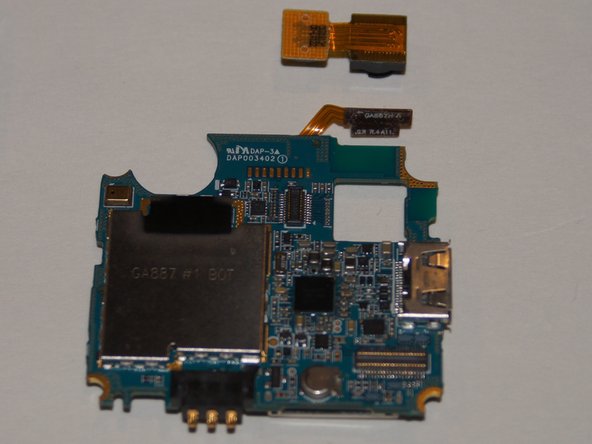

  8. Samsung Solstice Rear Facing Camera Replacement: crwdns2935265:08crwdnd2935265:01crwdnd2935265:02crwdne2935265:0 Samsung Solstice Rear Facing Camera Replacement: crwdns2935265:08crwdnd2935265:02crwdnd2935265:02crwdne2935265:0
    • Use a plastic opening tool to carefully pry the camera connector from its socket on the motherboard.
