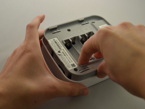

    3. Samsung SmartThings Hub USB Port Replacement: crwdns2935265:03crwdnd2935265:01crwdnd2935265:03crwdne2935265:0 Samsung SmartThings Hub USB Port Replacement: crwdns2935265:03crwdnd2935265:02crwdnd2935265:03crwdne2935265:0 Samsung SmartThings Hub USB Port Replacement: crwdns2935265:03crwdnd2935265:03crwdnd2935265:03crwdne2935265:0
      • Once all five screws are removed, split the casing apart by applying gentle upwards pressure against the positive terminals in the battery compartment.
