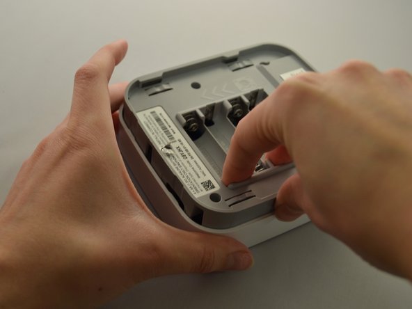

      • Make sure the batteries are removed before attempting disassembly.
      • Using your Phillips #1 screwdriver, remove the four visible 12.5mm screws.
      • Next, either peel up the longer of the two stickers or punch a hole with the tip of your screwdriver to access the fifth 12.5mm screw.

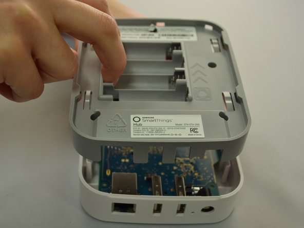

    3. Samsung SmartThings Hub Motherboard Replacement: crwdns2935265:03crwdnd2935265:01crwdnd2935265:03crwdne2935265:0 Samsung SmartThings Hub Motherboard Replacement: crwdns2935265:03crwdnd2935265:02crwdnd2935265:03crwdne2935265:0 Samsung SmartThings Hub Motherboard Replacement: crwdns2935265:03crwdnd2935265:03crwdnd2935265:03crwdne2935265:0
      • Once all five screws are removed, split the casing apart by applying gentle upwards pressure against the positive terminals in the battery compartment.
