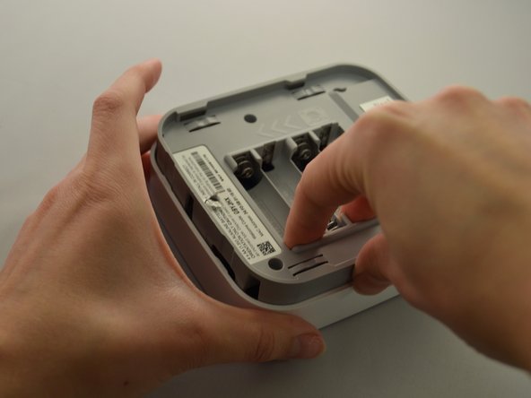

      • Using your Phillips #1 screwdriver, remove the four visible 12.5mm screws.
      • Next, either peel up the longer of the two stickers or punch a hole with the tip of your screwdriver to access the fifth 12.5mm screw.

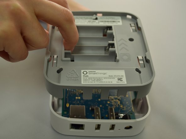

      • Once all five screws are removed, split the casing apart by applying gentle upwards pressure against the positive terminals in the battery compartment.

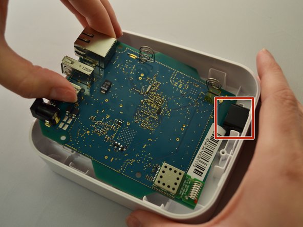

      • To remove the motherboard, grip the USB port and the Ethernet port. Lift up, then slide towards the front of the device to release the motherboard from the black retaining clip shown on the right.

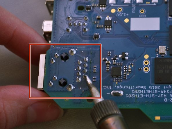

      • Preheat your soldering iron. The Ethernet port has fourteen points of connection to the motherboard (pictured below). Using your soldering iron, apply heat to each solder joint in turn while pulling the Ethernet port away from the board.
      • Soldering irons can reach temperatures of over 500 degrees. Watch your fingers!
      • For more information on soldering refer to How to Solder and Desolder Connections
