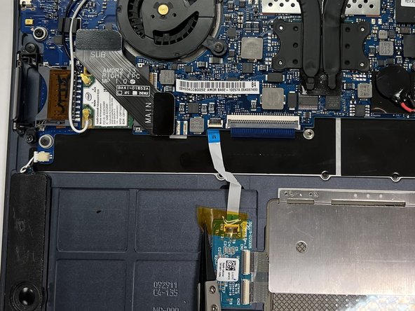

    • Unscrew the internal battery and disconnect it from the motherboard.
    • Look for the ribbon cable connection. Use the spudger to pull up the clip and unlock the ribbon cable.
    • Remove all of the cables and tapes using the plastic spudger.

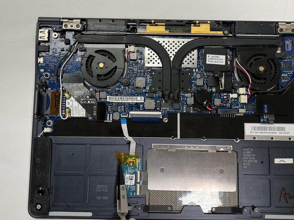

  3. Samsung Series 9 NP900X3C-A02US Touch Pad Replacement: crwdns2935265:03crwdnd2935265:01crwdnd2935265:01crwdne2935265:0
    • Holding the touchpad carefully in place, pull out the tapes.

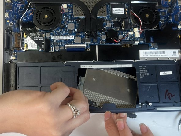

    • Using the prying tool, unstick and detach the module by lifting it from the base.
  5. Samsung Series 9 NP900X3C-A02US Touch Pad Replacement: crwdns2935265:05crwdnd2935265:01crwdnd2935265:02crwdne2935265:0 Samsung Series 9 NP900X3C-A02US Touch Pad Replacement: crwdns2935265:05crwdnd2935265:02crwdnd2935265:02crwdne2935265:0
    • Remove the four 0.1mm screws along the edges of the touchpad using a Phillips #00 screwdriver.
    • Slightly open the laptop and push on the module downwards with your fingertips gently. It should release from the sides and drop in the space created by slightly opening the laptop.
    • After removing the touchpad, clean it thoroughly using rubbing alcohol and a microfiber cloth. Pay special attention to the edges and corners as they will have the most leftover grime.
