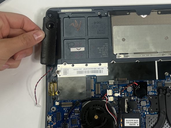

    • Remove the back cover of the laptop by using a Phillips #00 screwdriver to remove the 2 mm screws.
    • Pry out the bottom panel on all sides using a prying tool.
  3. Samsung Series 9 NP900X3C-A02US Sound/Speaker Replacement: crwdns2935265:03crwdnd2935265:01crwdnd2935265:01crwdne2935265:0
    • Unplug the right speakers cable from the motherboard.
  4. Samsung Series 9 NP900X3C-A02US Sound/Speaker Replacement: crwdns2935265:04crwdnd2935265:01crwdnd2935265:03crwdne2935265:0 Samsung Series 9 NP900X3C-A02US Sound/Speaker Replacement: crwdns2935265:04crwdnd2935265:02crwdnd2935265:03crwdne2935265:0 Samsung Series 9 NP900X3C-A02US Sound/Speaker Replacement: crwdns2935265:04crwdnd2935265:03crwdnd2935265:03crwdne2935265:0
    • Carefully lift up and remove the right speaker with an opening tool.
