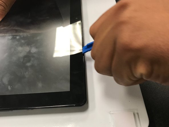

    • Wedge the opening tools inside the side of the device, and move it around the parameter until you have loosened the adhesive holding it together.

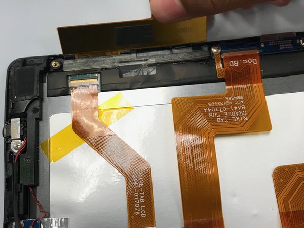

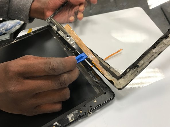

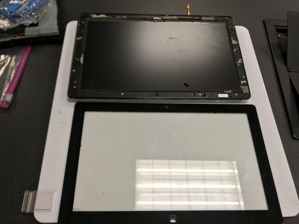

    • With the back panel now removed, wedge the opening tools in between the actual tablet and screen and move it around parameter until you have loosened the adhesive keeping it together.
  4. Samsung Series 7XE700T1A Screen Replacement: crwdns2935265:04crwdnd2935265:01crwdnd2935265:02crwdne2935265:0 Samsung Series 7XE700T1A Screen Replacement: crwdns2935265:04crwdnd2935265:02crwdnd2935265:02crwdne2935265:0

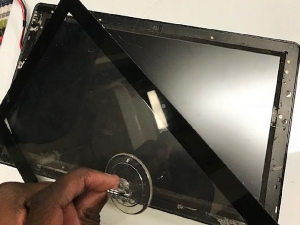

    • Place suction cup firmly on screen. When the cup is secure, lift up the screen and remove the screen.

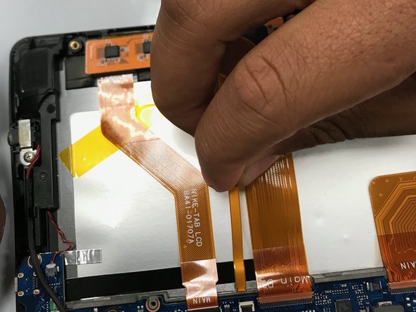

  5. Samsung Series 7XE700T1A Screen Replacement: crwdns2935265:05crwdnd2935265:01crwdnd2935265:03crwdne2935265:0 Samsung Series 7XE700T1A Screen Replacement: crwdns2935265:05crwdnd2935265:02crwdnd2935265:03crwdne2935265:0 Samsung Series 7XE700T1A Screen Replacement: crwdns2935265:05crwdnd2935265:03crwdnd2935265:03crwdne2935265:0
    • There is some circuitry that needs to be removed that is keeping the screen and tablet together.
    • The main circuitry that is connected to the screen and tablet together is the skinny one located in the middle.
    • Using your hands, pull the circuit out from its position to help loosen the connection.

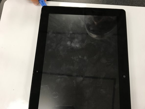

  6. Samsung Series 7XE700T1A Screen Replacement: crwdns2935265:06crwdnd2935265:01crwdnd2935265:03crwdne2935265:0 Samsung Series 7XE700T1A Screen Replacement: crwdns2935265:06crwdnd2935265:02crwdnd2935265:03crwdne2935265:0 Samsung Series 7XE700T1A Screen Replacement: crwdns2935265:06crwdnd2935265:03crwdnd2935265:03crwdne2935265:0
    • With your opening tool, remove the circuitry from off the main screen, thus separating the screen from the tablet completely
