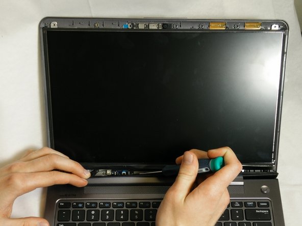

    • Before starting, make sure the device is powered off and unplugged to prevent electrocution.
    • Using a sharp object, pry the screen away from the back cover. Make sure to pry over the rubber rather than underneath as this can cause screws to break out.
    • This step is difficult! See if a friend will help you take the cover off as it is easier with two sets of hands pulling.

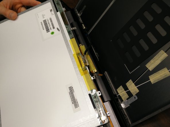

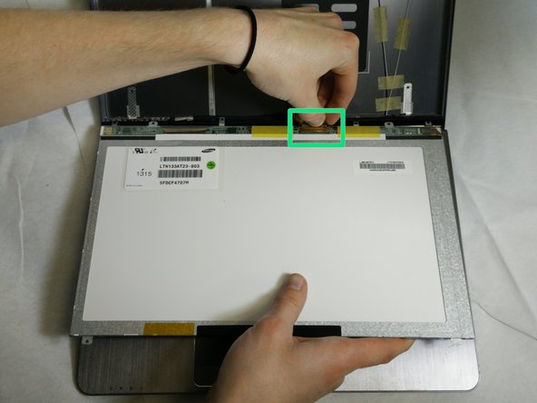

  5. Samsung Series 5 Ultrabook LCD Screen Replacement, Unplug the Video Connection: crwdns2935265:05crwdnd2935265:01crwdnd2935265:03crwdne2935265:0 Samsung Series 5 Ultrabook LCD Screen Replacement, Unplug the Video Connection: crwdns2935265:05crwdnd2935265:02crwdnd2935265:03crwdne2935265:0 Samsung Series 5 Ultrabook LCD Screen Replacement, Unplug the Video Connection: crwdns2935265:05crwdnd2935265:03crwdnd2935265:03crwdne2935265:0
    • Pull the screen down and remove the tape over the video connection.
    • Remove the video cables from the screen. This is easiest with tweezers.

In order to access the screens 2 lower screws, using a plastic tool unclip the plastic hinge at its join.There are a few further clips at the far edges. The plastic cover can now be removed and will reveal the lcd and touchscreen connectors. This is best done BEFORE attempting to loosen the touchscreen. The top screen frame does not have to be removed in order to remove the lcd.
