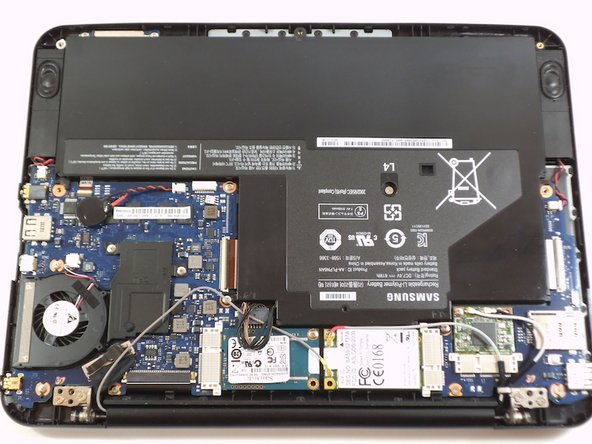

    • Place the laptop on a flat surface with the bottom side facing up.
    • Remove the rubber feet from the bottom of the panel using your fingernails.
    • Remove all the seven screws from the bottom panel.
  2. Samsung Series 5 3G Chromebook 16 GB SanDisk Replacement: crwdns2935265:02crwdnd2935265:01crwdnd2935265:02crwdne2935265:0 Samsung Series 5 3G Chromebook 16 GB SanDisk Replacement: crwdns2935265:02crwdnd2935265:02crwdnd2935265:02crwdne2935265:0
    • Loosen the back cover panel using a spudger.
  3. Samsung Series 5 3G Chromebook 16 GB SanDisk Replacement: crwdns2935265:03crwdnd2935265:01crwdnd2935265:02crwdne2935265:0 Samsung Series 5 3G Chromebook 16 GB SanDisk Replacement: crwdns2935265:03crwdnd2935265:02crwdnd2935265:02crwdne2935265:0
    • Once you work your way around, you can remove the panel.
  4. Samsung Series 5 3G Chromebook 16 GB SanDisk Replacement, 16 GB SanDisk: crwdns2935265:04crwdnd2935265:01crwdnd2935265:03crwdne2935265:0 Samsung Series 5 3G Chromebook 16 GB SanDisk Replacement, 16 GB SanDisk: crwdns2935265:04crwdnd2935265:02crwdnd2935265:03crwdne2935265:0 Samsung Series 5 3G Chromebook 16 GB SanDisk Replacement, 16 GB SanDisk: crwdns2935265:04crwdnd2935265:03crwdnd2935265:03crwdne2935265:0
    • Remove the single screw.
    • use the plastic tool to disconnect the WWAN antennas from the board.
    • After removing its mounting screw, the 16 GB SanDisk can be removed from the motherboard.
