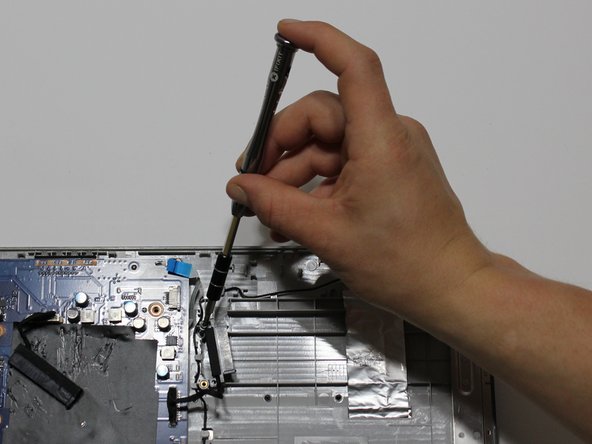

    • Using the J0 Japanese Industrial Standard screwdriver, remove the 3.5mm screw from the chip connected to the USB ports.

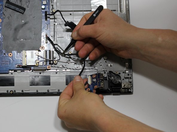

    • Using the tweezers, gently pry up the chip and ports, and unthread the wire from its holders, without crimping the wires.
  12. Samsung Series 3 NP300E5A-A02UB AC DC Powerjack  Replacement: crwdns2935265:012crwdnd2935265:01crwdnd2935265:02crwdne2935265:0 Samsung Series 3 NP300E5A-A02UB AC DC Powerjack  Replacement: crwdns2935265:012crwdnd2935265:02crwdnd2935265:02crwdne2935265:0

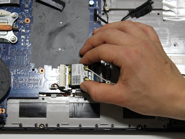

    • Using the J0 Japanese Industrial Standard screwdriver, remove the 4.5mm screw holding down the chip next to the power prongs where the battery connects.
    • Gently pull the chip from its connector.

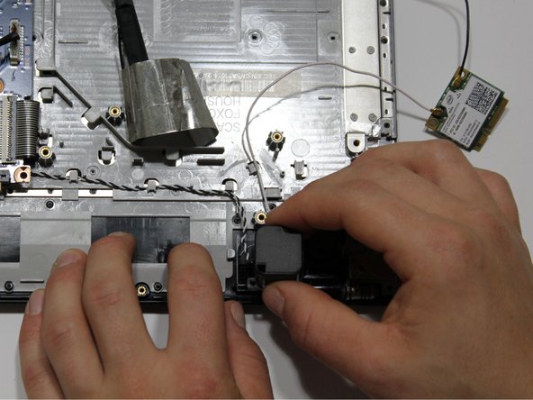

    • Gently pull up the speaker towers from either end of the computer.
  16. Samsung Series 3 NP300E5A-A02UB AC DC Powerjack  Replacement: crwdns2935265:016crwdnd2935265:01crwdnd2935265:02crwdne2935265:0 Samsung Series 3 NP300E5A-A02UB AC DC Powerjack  Replacement: crwdns2935265:016crwdnd2935265:02crwdnd2935265:02crwdne2935265:0
    • Using the blunt tweezers, unthread the wires that connect the motherboard to the speakers from their holders, without crimping the wires.

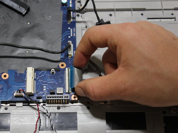

    • Using the iFixit opening tool, gently pry up the plastic clasp that holds the keyboard power circuit down, and pull out the strip from the connection.
  18. Samsung Series 3 NP300E5A-A02UB AC DC Powerjack  Replacement: crwdns2935265:018crwdnd2935265:01crwdnd2935265:01crwdne2935265:0
    • Pull out the plastic cover to release the Kotl strip, then pull out the strip.

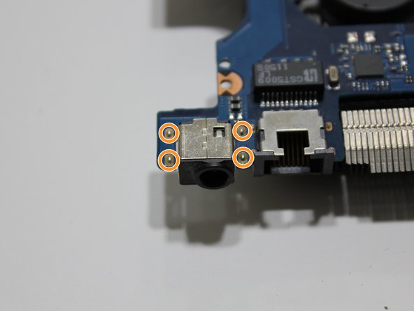

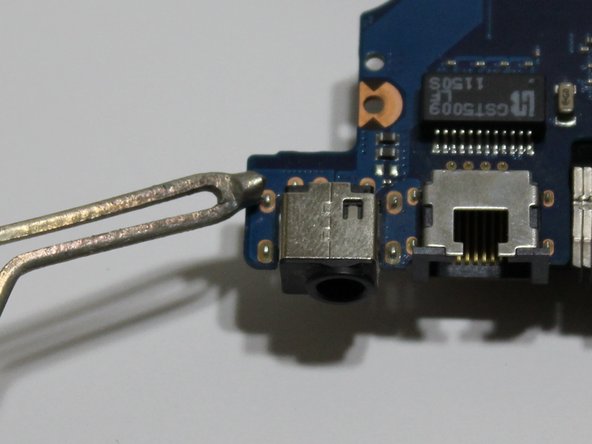

  20. Samsung Series 3 NP300E5A-A02UB AC DC Powerjack  Replacement, AC DC Powerjack: crwdns2935265:020crwdnd2935265:01crwdnd2935265:02crwdne2935265:0 Samsung Series 3 NP300E5A-A02UB AC DC Powerjack  Replacement, AC DC Powerjack: crwdns2935265:020crwdnd2935265:02crwdnd2935265:02crwdne2935265:0
    • Locate the power jack on the corner of the motherboard.
    • Locate the four connectors that hold the power jack to the motherboard.
  21. Samsung Series 3 NP300E5A-A02UB AC DC Powerjack  Replacement: crwdns2935265:021crwdnd2935265:01crwdnd2935265:02crwdne2935265:0 Samsung Series 3 NP300E5A-A02UB AC DC Powerjack  Replacement: crwdns2935265:021crwdnd2935265:02crwdnd2935265:02crwdne2935265:0
    • Using the Soldering Station, remove the power jack from the four connectors.
  22. Samsung Series 3 NP300E5A-A02UB AC DC Powerjack  Replacement: crwdns2935265:022crwdnd2935265:01crwdnd2935265:01crwdne2935265:0
    • Solder the new power jack in place by reattaching the four connectors.
After soldering the new power jack in place, reassemble your device by following these instructions in reverse order.
