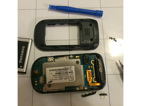

  3. Samsung SPH-M360 Keyboard Replacement, Casing: crwdns2935265:03crwdnd2935265:01crwdnd2935265:01crwdne2935265:0
    • Remove the four screws on the corners of the casing.
    • The volume and camera buttons may fall out

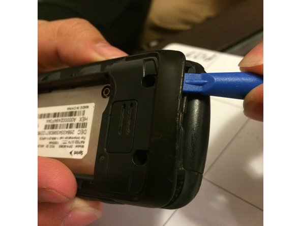

  4. Samsung SPH-M360 Keyboard Replacement: crwdns2935265:04crwdnd2935265:01crwdnd2935265:02crwdne2935265:0 Samsung SPH-M360 Keyboard Replacement: crwdns2935265:04crwdnd2935265:02crwdnd2935265:02crwdne2935265:0
    • Starting near the top of the casing, use the plastic opening tool to gently pry the casing open.
    • The case should require some effort to pry open, but do not use excessive force for risk of breaking the rear panel.
    • Slowly work the plastic opening tool around the edge of the casing, gently prying it around at all sides.
  5. Samsung SPH-M360 Keyboard Replacement: crwdns2935265:05crwdnd2935265:01crwdnd2935265:02crwdne2935265:0 Samsung SPH-M360 Keyboard Replacement: crwdns2935265:05crwdnd2935265:02crwdnd2935265:02crwdne2935265:0
    • Once the casing has been fully pried off of the phone, it should be easily removed by hand.
    • The buttons for the camera and volume may fall out while removing the casing. Be careful not to lose the small pieces.

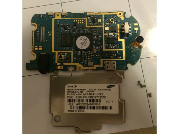

  6. Samsung SPH-M360 Keyboard Replacement, Logic Board: crwdns2935265:06crwdnd2935265:01crwdnd2935265:01crwdne2935265:0
    • Use the plastic opening tool to gently detach the golden strip from the logic board.
    • The strip should detach easily with little force required.
  7. Samsung SPH-M360 Keyboard Replacement: crwdns2935265:07crwdnd2935265:01crwdnd2935265:01crwdne2935265:0
    • Use the plastic opening tool to pry the logic board out of the phone case from the bottom area of the phone.
  8. Samsung SPH-M360 Keyboard Replacement: crwdns2935265:08crwdnd2935265:01crwdnd2935265:02crwdne2935265:0 Samsung SPH-M360 Keyboard Replacement: crwdns2935265:08crwdnd2935265:02crwdnd2935265:02crwdne2935265:0
    • Flip the logic board over and locate the three screws along the edges.
    • Carefully unscrew the three screws to remove the panel covering the logic board.
    • Be careful with the screws after unscrewing them because they are small and easy to lose.
  9. Samsung SPH-M360 Keyboard Replacement: crwdns2935265:09crwdnd2935265:01crwdnd2935265:02crwdne2935265:0 Samsung SPH-M360 Keyboard Replacement: crwdns2935265:09crwdnd2935265:02crwdnd2935265:02crwdne2935265:0
    • Flip the logic board back over and use the plastic opening tool to remove the metal cover on the logic board.
    • This will not require much force, so be gentle.
