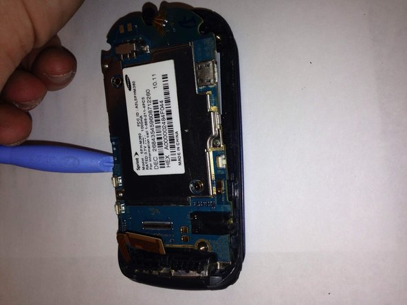

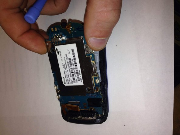

  6. Samsung SPH-M360 Keyboard Replacement, Remove the logic board: crwdns2935265:06crwdnd2935265:01crwdnd2935265:03crwdne2935265:0 Samsung SPH-M360 Keyboard Replacement, Remove the logic board: crwdns2935265:06crwdnd2935265:02crwdnd2935265:03crwdne2935265:0 Samsung SPH-M360 Keyboard Replacement, Remove the logic board: crwdns2935265:06crwdnd2935265:03crwdnd2935265:03crwdne2935265:0
    • Insert the plastic opening tool beneath the logic board.
    • While stabilizing the phone, gently lift the board away from the casing. Please do NOT force it! If it resists, apply even pressure in multiple locations.
    • For reassembly, press lightly in 2–4 areas until the board clicks securely into place.
