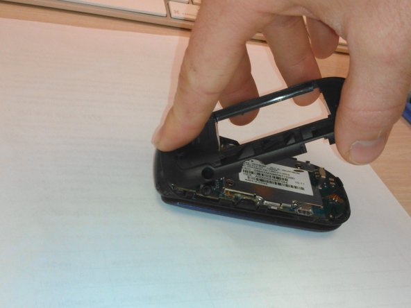

    4. Samsung SPH-M360 Case Replacement, Remove the back half of the case.: crwdns2935265:04crwdnd2935265:01crwdnd2935265:03crwdne2935265:0 Samsung SPH-M360 Case Replacement, Remove the back half of the case.: crwdns2935265:04crwdnd2935265:02crwdnd2935265:03crwdne2935265:0 Samsung SPH-M360 Case Replacement, Remove the back half of the case.: crwdns2935265:04crwdnd2935265:03crwdnd2935265:03crwdne2935265:0
      • Using your plastic opening tool, pry under the back case starting with the top as marked by red circle.
      • There is a small clip at the top of the phone that must be released in order to remove the back case.

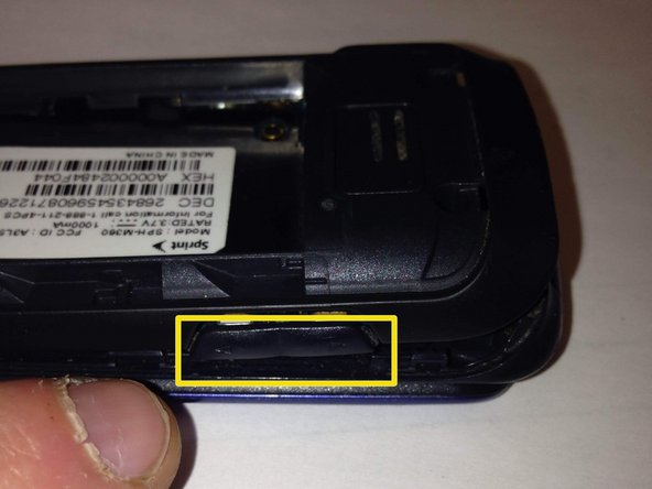

      • The volume button and camera button are held in by the back case. Volume button pictured. Camera button opposite.
      • REASSEMBLY ONLY: Replace volume and camera buttons in place. Then, insert the top of the back case FIRST and squeeze together clips as you work toward the bottom of the phone.
