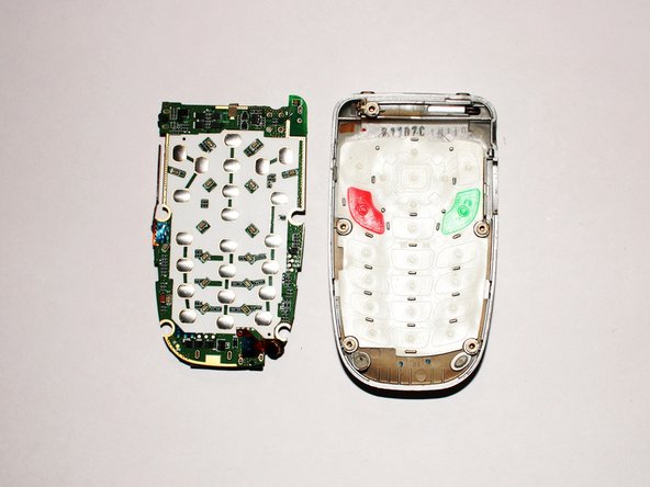

  6. Samsung SPH-A660 Teardown: crwdns2935265:06crwdnd2935265:01crwdnd2935265:03crwdne2935265:0 Samsung SPH-A660 Teardown: crwdns2935265:06crwdnd2935265:02crwdnd2935265:03crwdne2935265:0 Samsung SPH-A660 Teardown: crwdns2935265:06crwdnd2935265:03crwdnd2935265:03crwdne2935265:0
    • Remove the logic board from the phone by gently lifting up on the large green logic board with the plastic opening tool.
  7. Samsung SPH-A660 Teardown: crwdns2935265:07crwdnd2935265:01crwdnd2935265:03crwdne2935265:0 Samsung SPH-A660 Teardown: crwdns2935265:07crwdnd2935265:02crwdnd2935265:03crwdne2935265:0 Samsung SPH-A660 Teardown: crwdns2935265:07crwdnd2935265:03crwdnd2935265:03crwdne2935265:0
    • Remove the keypad from the body by grasping the white rubbery pad and lifting it off the phone.

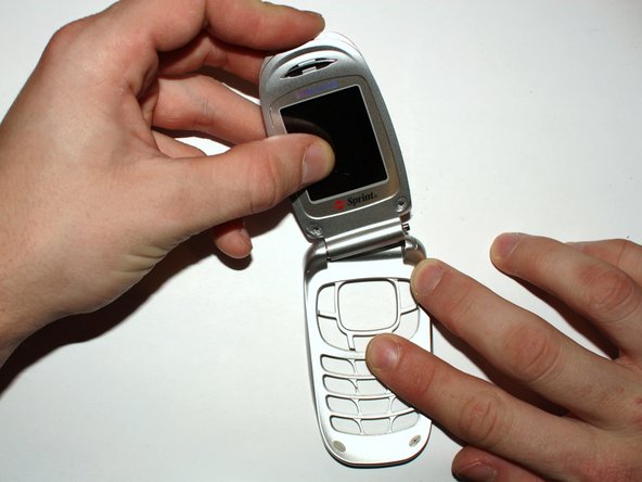

  9. Samsung SPH-A660 Teardown: crwdns2935265:09crwdnd2935265:01crwdnd2935265:02crwdne2935265:0 Samsung SPH-A660 Teardown: crwdns2935265:09crwdnd2935265:02crwdnd2935265:02crwdne2935265:0
    • Remove the two highlited screws from the phone below the screen in order to open the display area.

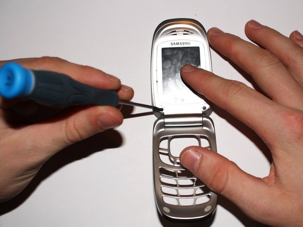

  10. Samsung SPH-A660 Teardown: crwdns2935265:010crwdnd2935265:01crwdnd2935265:02crwdne2935265:0 Samsung SPH-A660 Teardown: crwdns2935265:010crwdnd2935265:02crwdnd2935265:02crwdne2935265:0
    • Pry the phone display open by inserting a plastic opening tool into the crack that runs along the side of the phone display under the screws.
    • Once you have the display cover wedged open, use your fingers to pry the whole cover off the phone.
    • Some force may be needed to remove the cover, as several tabs are there which hold the two parts in place. Therefore, be careful when prying the cover apart

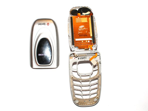

  11. Samsung SPH-A660 Teardown: crwdns2935265:011crwdnd2935265:01crwdnd2935265:03crwdne2935265:0 Samsung SPH-A660 Teardown: crwdns2935265:011crwdnd2935265:02crwdnd2935265:03crwdne2935265:0 Samsung SPH-A660 Teardown: crwdns2935265:011crwdnd2935265:03crwdnd2935265:03crwdne2935265:0
    • Be Extremely Careful in this next step as if you pry the hinge off too fast you may rip the connector between the logic board and screen.
    • Carefully wedge a plastic opening tool between the hinge on the body as shown in the highlited area in picture two. (be sure to insert the wedge into the right hinge when looking down onto the phone as in the picture).
    • Slowly pry the hinge off the body as shown in the third picture and set the phone down when you get to this step.
    • Next slide the connector cable out of the slot on the back side of the phone and the screen will be disconnected from the key pad body.
