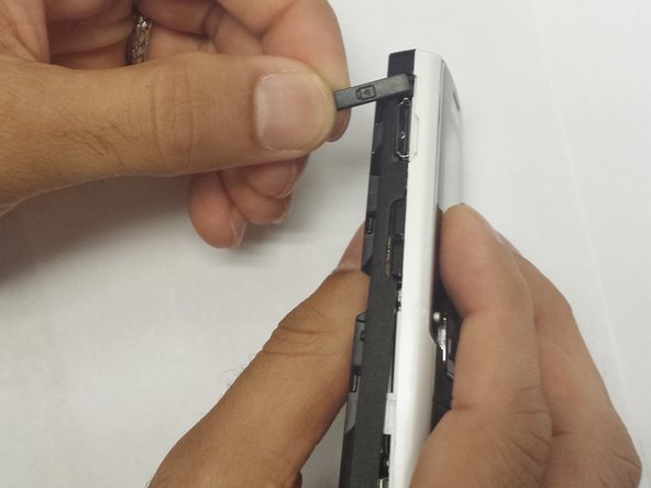

      • Remove the headphone cover from the left side and the volume cover from the right side of the phone.
