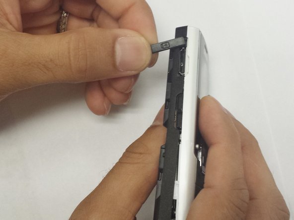

  5. Samsung SPEX SCH-R210 Speaker Replacement: crwdns2935265:05crwdnd2935265:01crwdnd2935265:02crwdne2935265:0 Samsung SPEX SCH-R210 Speaker Replacement: crwdns2935265:05crwdnd2935265:02crwdnd2935265:02crwdne2935265:0
    • Remove the small, black headphone cover from the left side of the phone by gently pulling it off.
    • Remove the small, black volume cover from the right side of the phone by gentle pulling it off.
