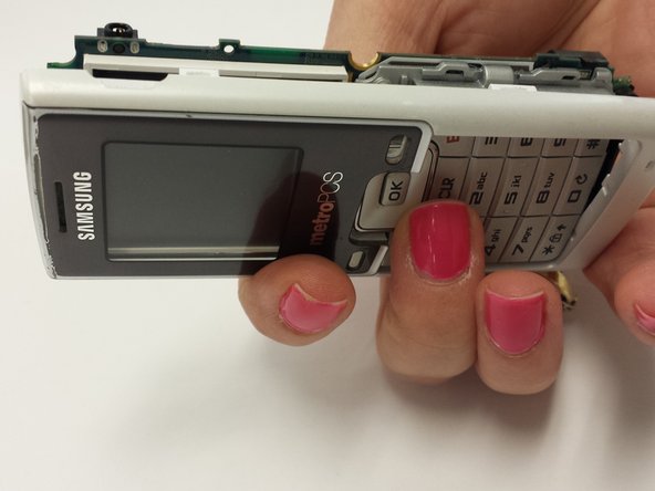

    1. Samsung SPEX SCH-R210 Keypad Replacement, Keypad: crwdns2935265:04crwdnd2935265:01crwdnd2935265:02crwdne2935265:0 Samsung SPEX SCH-R210 Keypad Replacement, Keypad: crwdns2935265:04crwdnd2935265:02crwdnd2935265:02crwdne2935265:0
      • Remove the four 4.8 mm screws from the midframe using a Phillips #00 screwdriver.
    2. Samsung SPEX SCH-R210 Keypad Replacement: crwdns2935265:05crwdnd2935265:01crwdnd2935265:01crwdne2935265:0
      • Remove the headphone cover from the left side of the midframe.
    3. Samsung SPEX SCH-R210 Keypad Replacement: crwdns2935265:06crwdnd2935265:01crwdnd2935265:01crwdne2935265:0
      • Remove the volume cover from the right side of the midframe.
    4. Samsung SPEX SCH-R210 Keypad Replacement: crwdns2935265:07crwdnd2935265:01crwdnd2935265:01crwdne2935265:0
      • Use your hands to separate the midframe from the rest of the phone.
      • This may take a little effort to remove.
    5. Samsung SPEX SCH-R210 Keypad Replacement: crwdns2935265:08crwdnd2935265:01crwdnd2935265:01crwdne2935265:0
      • Use a 1.5 mm hex screwdriver to remove the three 2.4 mm screws around the motherboard.
    6. Samsung SPEX SCH-R210 Keypad Replacement: crwdns2935265:09crwdnd2935265:01crwdnd2935265:01crwdne2935265:0
      • Lift the metal plate off of the motherboard and set it aside.
    7. Samsung SPEX SCH-R210 Keypad Replacement: crwdns2935265:010crwdnd2935265:01crwdnd2935265:02crwdne2935265:0 Samsung SPEX SCH-R210 Keypad Replacement: crwdns2935265:010crwdnd2935265:02crwdnd2935265:02crwdne2935265:0
      • Push on the white plastic tabs and the keypad at the same time to remove the motherboard.
    8. Samsung SPEX SCH-R210 Keypad Replacement: crwdns2935265:011crwdnd2935265:01crwdnd2935265:02crwdne2935265:0 Samsung SPEX SCH-R210 Keypad Replacement: crwdns2935265:011crwdnd2935265:02crwdnd2935265:02crwdne2935265:0
      • Turn the phone over to its front side.
      • Apply pressure on the keypad.
      • The keypad will come out easily.
