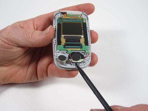

  6. Samsung SGH-X495 Speakers Replacement, Speakers: crwdns2935265:06crwdnd2935265:01crwdnd2935265:02crwdne2935265:0 Samsung SGH-X495 Speakers Replacement, Speakers: crwdns2935265:06crwdnd2935265:02crwdnd2935265:02crwdne2935265:0
    • Remove the 2 speakers by gently prying them up.
    • The speakers are attached with double sided tape.
  7. Samsung SGH-X495 Speakers Replacement: crwdns2935265:07crwdnd2935265:01crwdnd2935265:01crwdne2935265:0
    • With the speakers free from the phones body the screen is loose as well.
    • The desired solder joint can be accessed to attach a new speaker.
