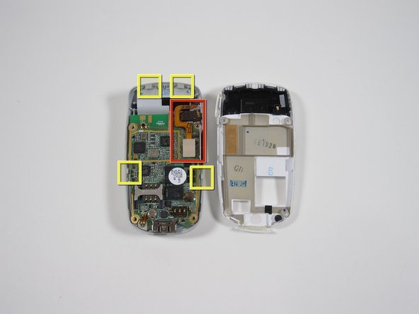

    4. Samsung SGH-X495 Screen Replacement: crwdns2935265:04crwdnd2935265:01crwdnd2935265:02crwdne2935265:0 Samsung SGH-X495 Screen Replacement: crwdns2935265:04crwdnd2935265:02crwdnd2935265:02crwdne2935265:0
      • Begin by inserting the pry tool near the charger jack.
      • There are 4 tabs to release.
      • Start at the bottom and slide the tool up, lifting the silver front of the phone away from the white backing.
      • Loosen the 2 side tabs before moving on to the top two.
      • See the second photo to see location of the tabs.
      • Be careful of the ribbon wires shown in second photo.
    5. Samsung SGH-X495 Screen Replacement: crwdns2935265:05crwdnd2935265:01crwdnd2935265:02crwdne2935265:0 Samsung SGH-X495 Screen Replacement: crwdns2935265:05crwdnd2935265:02crwdnd2935265:02crwdne2935265:0
      • Once the two side tabs are free; gently pry the white backing down to release the top two tabs.
      • Hold the phone with the left hand as shown
      • Wiggle the white backplate from side to side while pulling down with the right hand.
